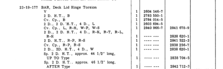

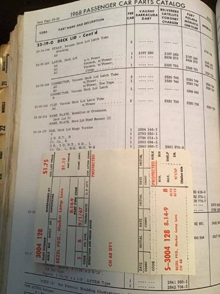

Who's good at deciphering the Parts Book? Looks like as long as its from a Coronet & not a Satellite it should be fine... 2dr, 4dr & vert... But maybe to lengths depending on production date??? I'm I reading it right?

Who's good at deciphering the Parts Book? Looks like as long as its from a Coronet & not a Satellite it should be fine... 2dr, 4dr & vert... But maybe to lengths depending on production date??? I'm I reading it right? View attachment 846309
I'm as confused as you in reading the parts book. I have a guy that works in parts at the local dealership that figures things like that out when I can't.

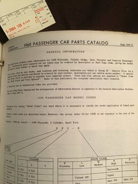

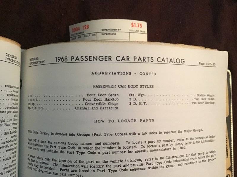

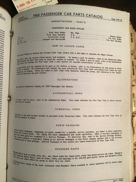

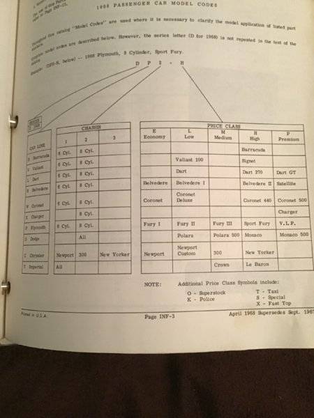

Sorry I’m late on this. For future reference, Up in the front of all the catalogs under the general information tab is an abbreviation list. Always reference that if there is any confusion. :thumbsup:
Cv. Cp. is shorthand for convertible coupe. Depending on what is being looked up, sometimes you’ll need the price class Etc.
