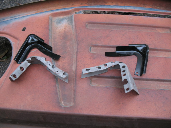

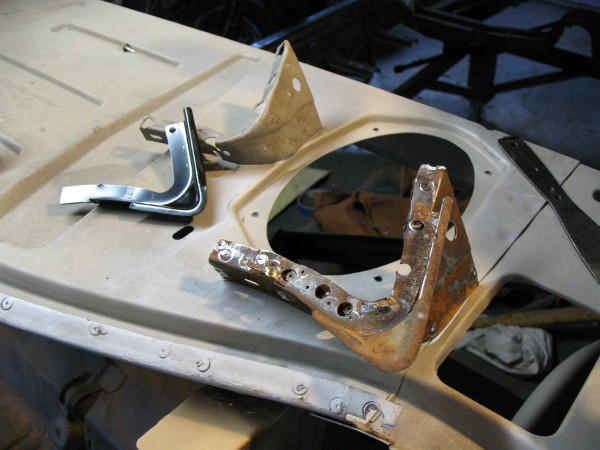

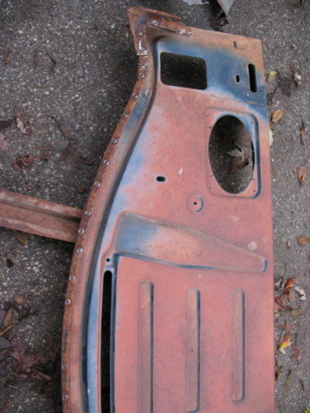

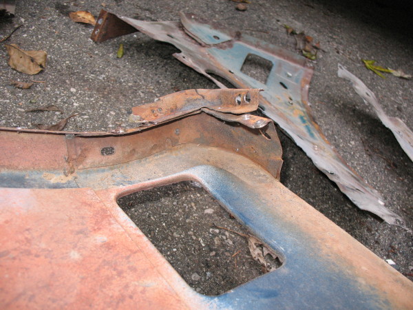

Here are a few pics of the area in question, all of the layers are welded to eachother where they overlap. Hope this helps.

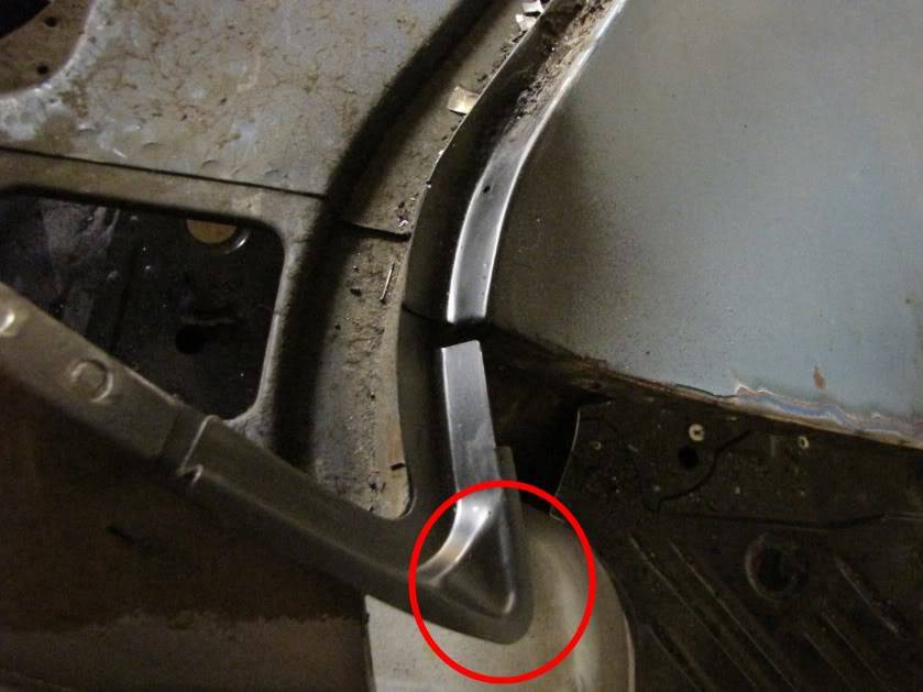

Thanks for posting the pic's Matt.....Just to confirm what you're saying, the quarter needs to be welded to the window corner bracket in the very corner of the rear windshield area where the quarter seats on top, as well as the sides of the bracket.... See pic below:
Thanks again Buddy
Thanks for emailing over the article with pic's Matt. Much appreciated! Good to know they weld up in that particular area.
