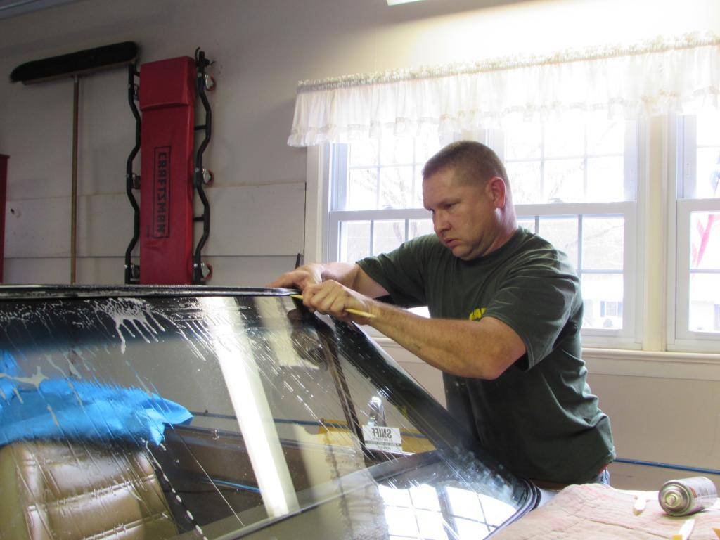

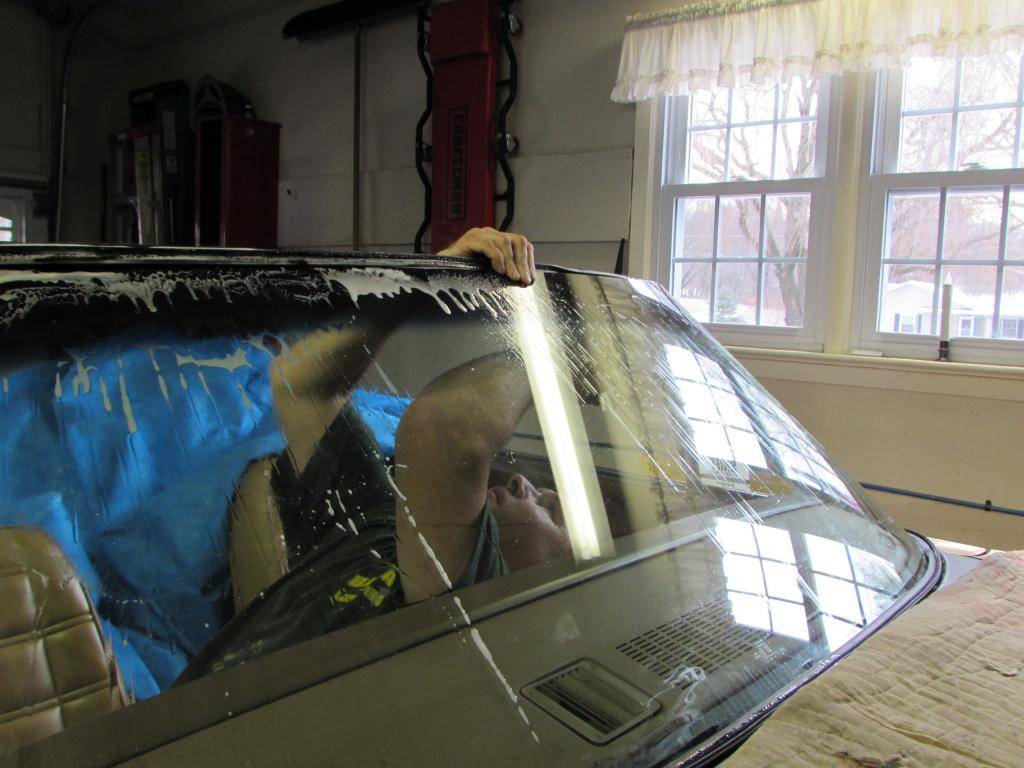

To install the windshield, lay the windshield down in the bottom channel first. Spray a liberal amount of window cleaner onto the rubber gasket. This will help with lubricating the gasket and allow it to slip around the glass and let the glass seat into the channel. Start with getting the lower channel of the gasket around and having the window seat into the channel. It is important to take your time with this so as not to rip or tear the rubber gasket. Continue working the gasket around the glass into place making sure you do not pry on the glass itself. Continue working the gasket into place with occasionally slapping the glass with the palm of your hand to help it seat into place. One area that I noticed a great deal of difficulty was the top corners of the gasket. Again, taking your time and using ample amounts of spray window cleaner, it can be done, however, your patience can be tried!

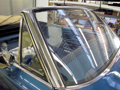

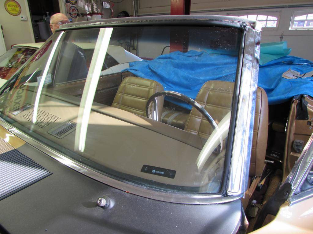

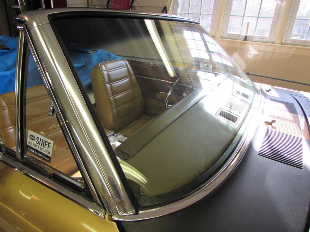

Yesterday, I had a PM from someone who was working on doing a windshield for a similar sister car, a 69 Coronet convertible. He was inquiring how the trim came off and I realized I had forgotten to post those pics. Be aware that the convertible trim is different than the hard top trim pieces. I have to say between my charger and Dad's GTX vert, the trim on the charger was a LOT easier as it required less stuff to remove. On the convertibles, you first needs to drop the top to expose the 7 screws that hold the two piece top windshield / header trim. Once that is removed, you can then move on to the side A pillar trim. This needs to have the A post weather stripping removed to reveal the 4 screws that holds the stainless bracket in place that holds the weather stripping. Once that is off, you will find another set of 4 screws that holds the trim for the A pillar windshield trim. Now that the A pillar trim is off, you can remove the lower two piece windshield trim with the special trim removal hook / tool. Installation is in the reverse order taking time to install all of the screws loose till all of the screws are in. Then you can go back and tighten them snug.
Pictures are from when I was installing the trim. Removal would be in the reverse order.
lower windshield trim
A pillar windshield trim installed, weather stripping stainless bracket being lined up.
Header / upper windshield trim installed
trim all installed

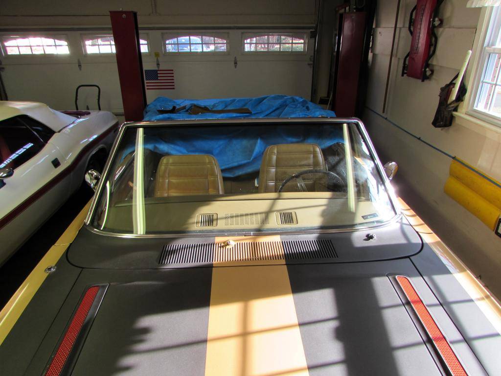

completed project with wiper arms reinstalled
