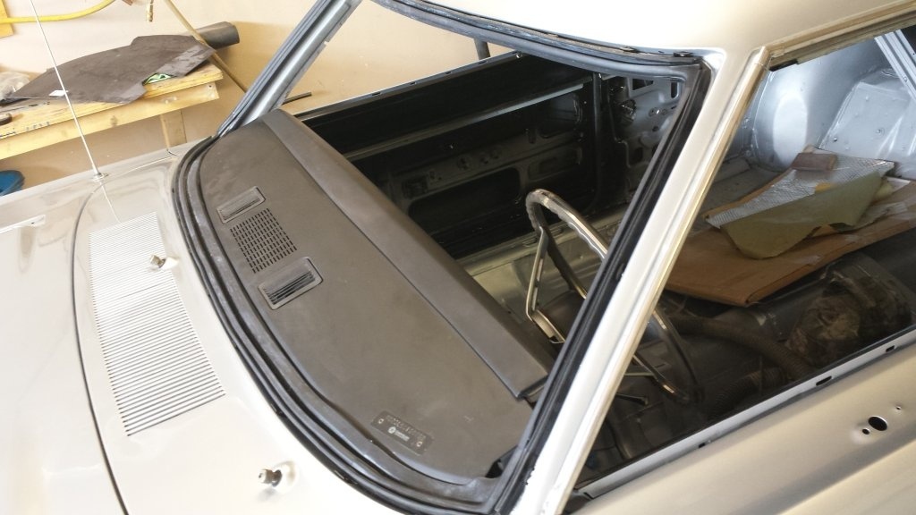

gonna be installing the windshield since the dash is now installed who makes the best reproduction gasket?

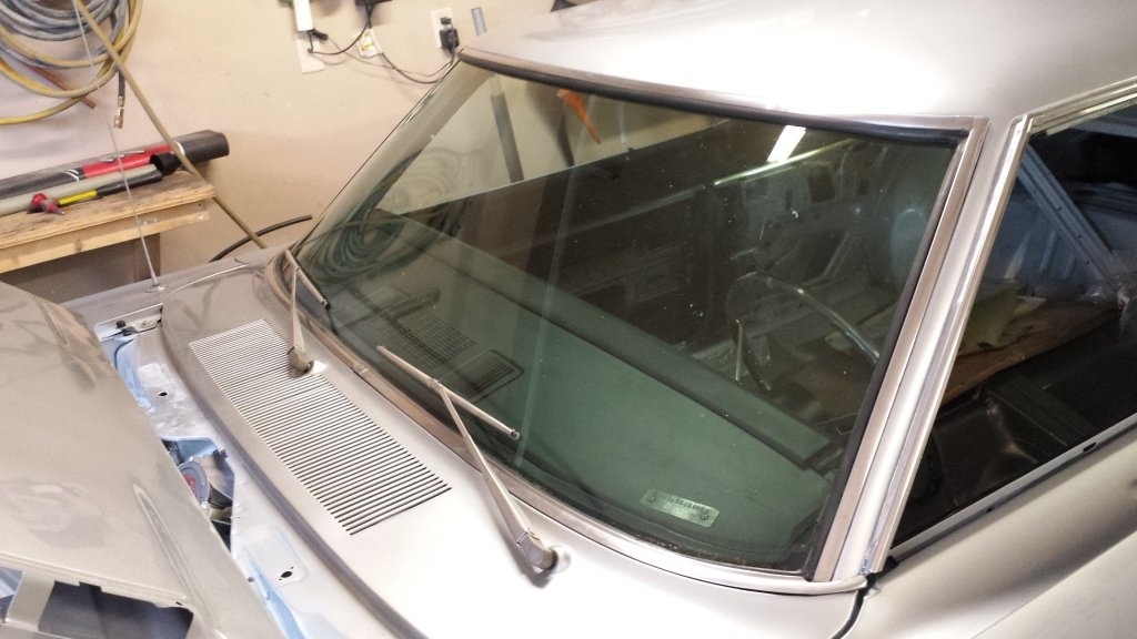

How about stainless trim fit ? I hear some gaskets interfere unless the sealer is just the right thickness.............................MO
With the clips and gasket from classic industries everything fit back into place like it was born to do it
The AMD gasket fit the front trim excellent, no issues.
As long as you do not go crazy with the sealer, the front trim will not be an issue. When doing the rear glass, it is best to test fit the glass with different thickness of the butyl tape. If you go too thick, the glass will be higher than the trim holding it off. Too low and there will be a small gap between the glass and trim, so it takes some test fitting and combinations to get the very best fit and finish.
