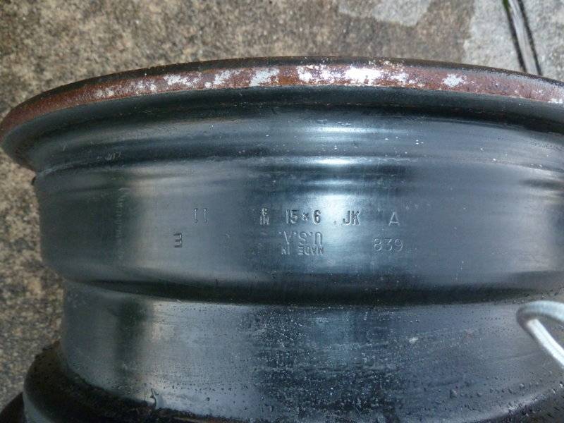

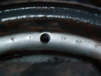

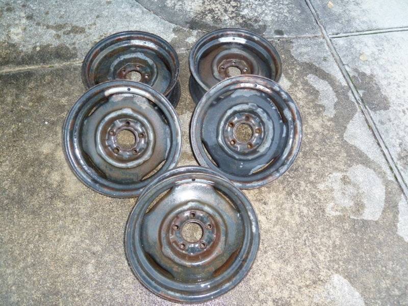

    I believe these are correct for 68 Hemi. 15x6.0 JK wheels. Look at center pattern. I would be interested in 69bfans answer also. This is a matched set.

    Dragon Slayer, those pictured above appear to be correct from my memory. My wheels are in a different building and I bought them so long ago that I have no pictures of them. From the pictures, you will note two distinct features of these wheels. First is the raised "nubs" in the center hub area. Granted, this area will be covered with even the poverty caps. For the 68 Chargers, full wheel covers were an option and seem to be fairly common on the Chargers. So if going that route, the covers will hide the other distinct feature. That is the inner wheel insert is relatively straight where it sits inside the outer band of the wheel. If your planning on running the poverty style hub caps, then this is an area that people who know the differences will zoom in on.
    Unfortunately, all of the correct steel wheels for any of the Hemi applications all through the years seem to be either impossible to find or sell for stupid dollars. The 69 "H" wheel and the "450" wheel are reproduced. But the 68 wheel will never be reproduced and I looked through probably close to 1500 wheels to never find the first one. The one set I bought was back in 1989 at the Mopar Nationals and the second set found me through word of mouth from seeking out parts for a 68 Road Runner.
    Good luck on the search.
