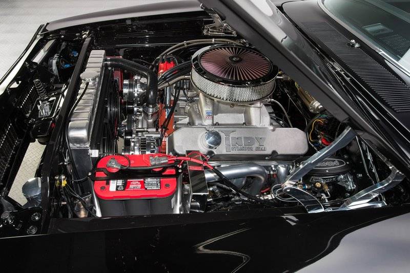

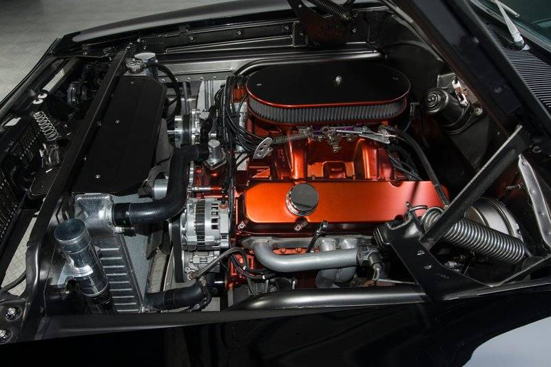

I found photos of two 70 Chargers with Indy 440-EZ-1 and Indy dual plane that fit under stock hood. So it seems like solution for me.
