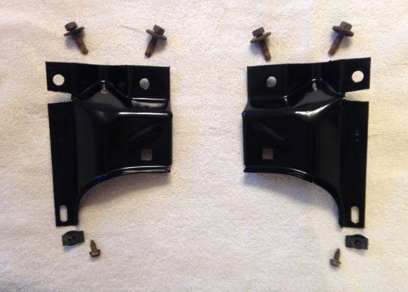

Here is the hardware from my 1970. I believe they were all the same. Year wise that is.
0000000000000000000000000000000000000000000000000000000000bumper brackets.JPG
Just took some measurements. The best I can tell the big bolts are...
7/16 NC X 1 3/4" long
The small ones are...
5/16 NC X 1"
The small ones are sort of chrome plated. The big one are that black chromate or phosphate coating. You know what I mean. The nice flat black ones.
