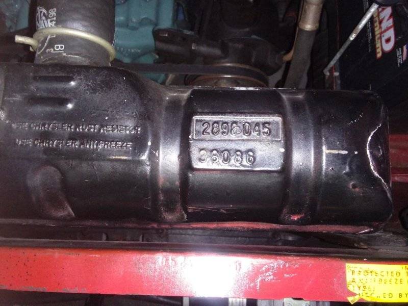

Code 45 on my BS: Radiator: 22” 383/440 w/AT “B” Body
Looking at the code 2898045, I can't see any listing in the parts catalog.
