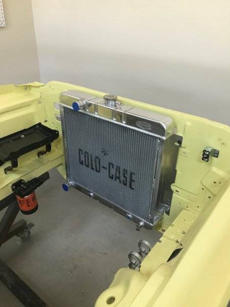

1st thing, measure your radiator. The core support will either take a 22" or a 26". You cannot put a 26" in a 22" slot. Measure the "core" part of your radiator left to right to determine which it is. Then you can decide where to go from there. US Radiator has a nice aluminum w stamped tanks that look close to stock when painted black for under $600. Other aluminum are usually square welded upper n lower tanks. For a stock 383 w air, a 2 row w 1" tubes and a factory shroud w fan clutch and proper size fan will be more than adequate. If your tanks on your stock radiator are good, a recore w a 3 row brass using modern core spacing will work too. Find another shop for an estimate on recore. But brass is expensive compared to aluminum.

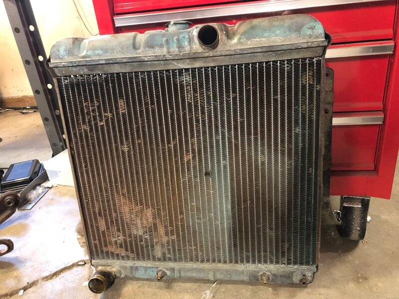

Said it had so many leaks that it would cost $600 to fix.
So, it was like this?

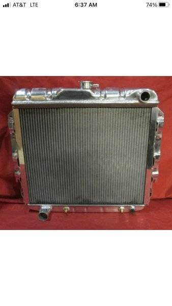

As I search for a radiator I find none in a 22 that has a passenger offset upper hose.
I reposted under heating and cooling.
Why paint it? Let the aluminum do what it does, transfer heat.
The key to the radiator quality is what size the tubes are.
