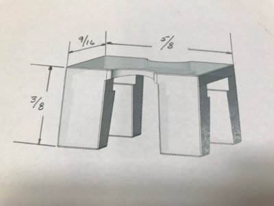

For a better understanding of what I'm looking for. These snap into the expanded section of the outer steering column and give support to the intermediate tube (shifter tube for column shift). These are designed for centering the tube in the column to prevent possible rattles and keep it from rubbing the actual steering shaft. If their not remanufactured I'll have to make them. I've designed a mold to make these so if anyone wants a set (4 per) I'll make a extra run of parts. These will be shot out of the same material the factory used (Nylon 66) FYI guys

I looked under every rock I could find but nobody has or makes these. I'm in the process of fabricating the mold for these parts. As far as price, that will be determined after I do some calculations on material cost/machine time but I'll it will be more than fair, I'm estimating in the ballpark of $8.00 to $10.00 for a set, maybe more maybe less. Nylon isn't the cheapest material to use but it's tough heck and will probably last longer than the restoration.

The manufacturing of the mold has started, should be done with it in about 4 to 6 weeks. I'll give a heads up when these parts are available.

No worries, tool is 70 percent complete. I'll give everyone a heads up when parts are available..
