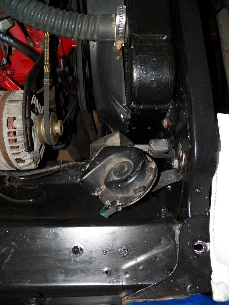

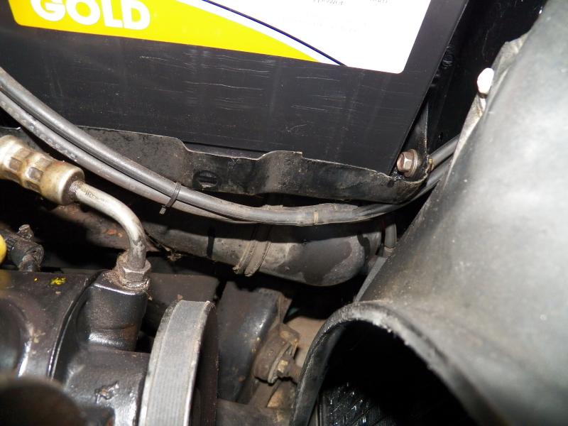

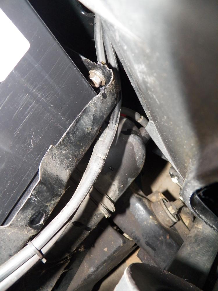

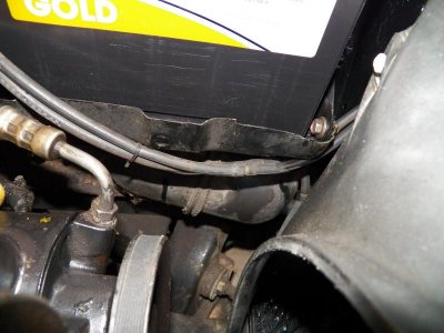

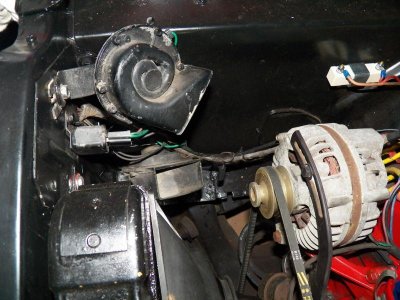

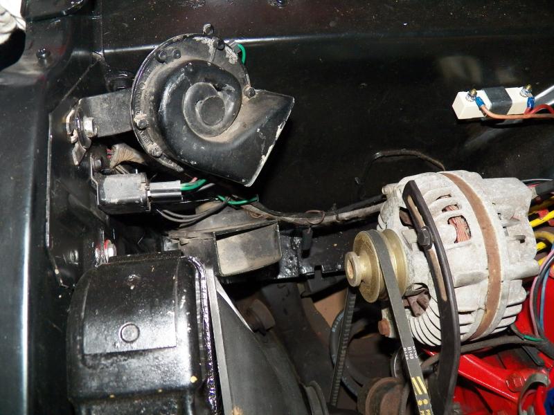

Here are a few pics, vac can and horns.

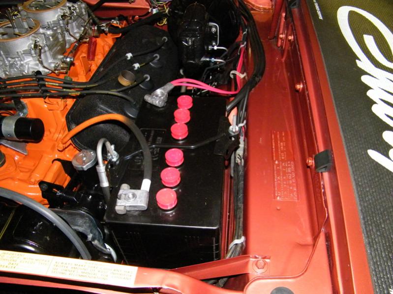

I don't know what that torpedo is under the battery tray in the above picture, but here's how a repro can looks and how the hoses are routed.....

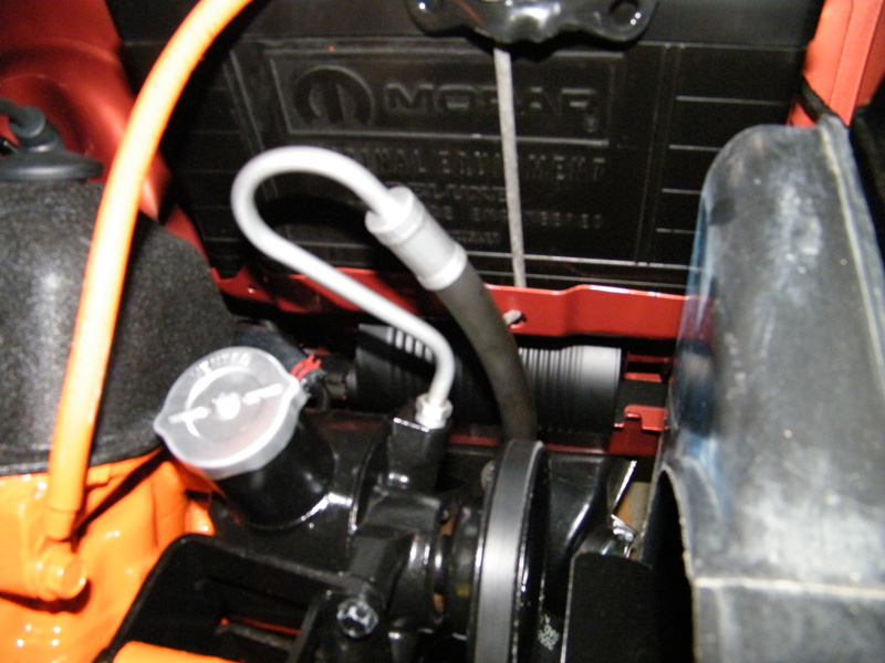

That's my vacuum canister for the headlights...right or wrong that's what's there and it works.
