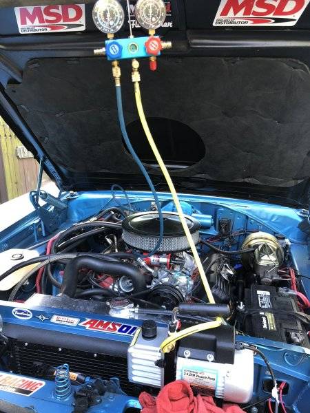

Tight and a drop base is required. I think 2.25” or 2.5” is shown. That was the deepest I could find. Note the hood insulation if you go back with it. All in I think there is 3/8” clear now.
