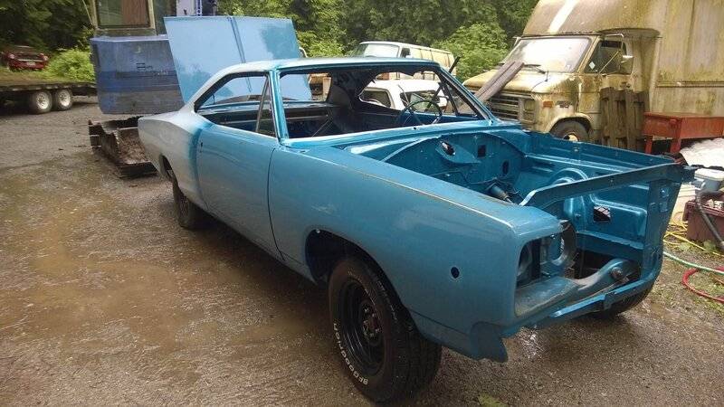

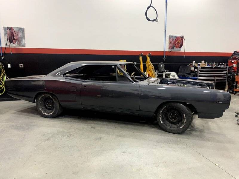

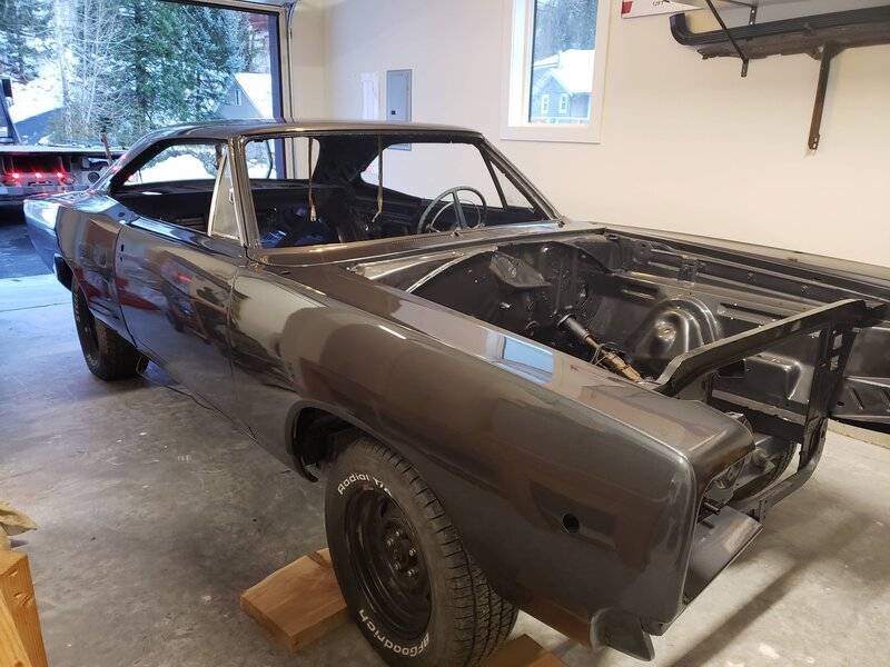

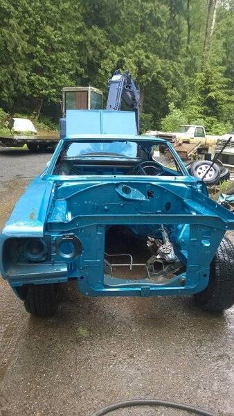

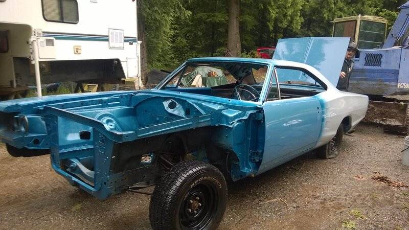

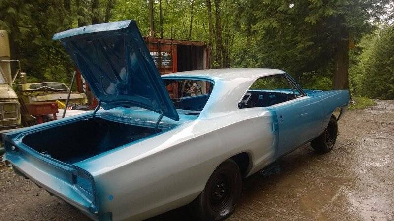

Here is a few picture of where we started

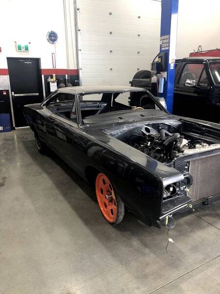

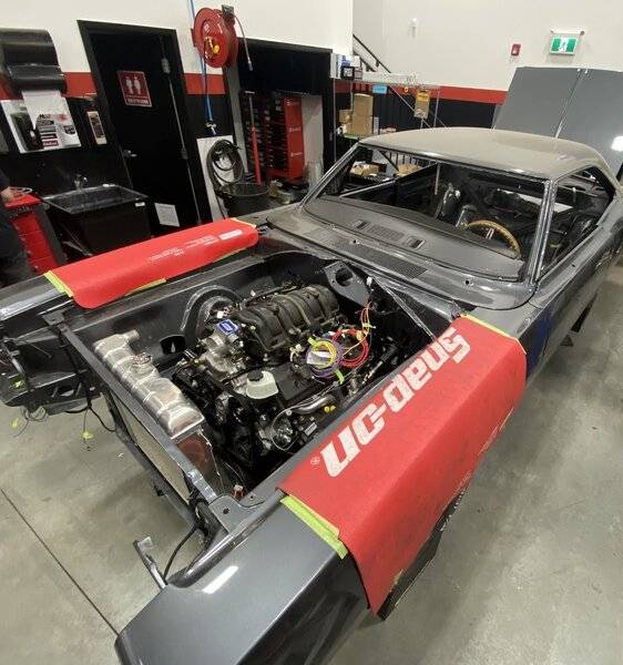

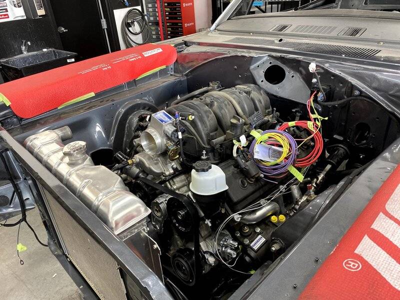

I started with a 5.7 hemi from a Durango. I did have an issue with the throttle body sticking up too high and would not allow my hood to close, so I purchased a car intake and front accessory kit. No w it fits perfect.

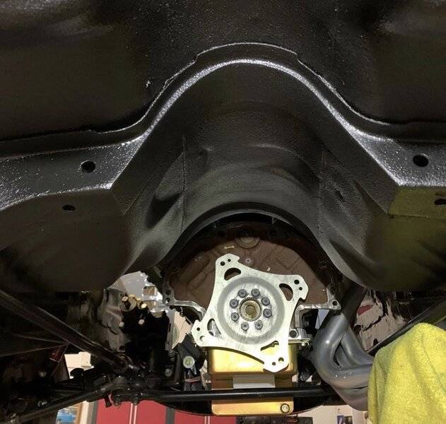

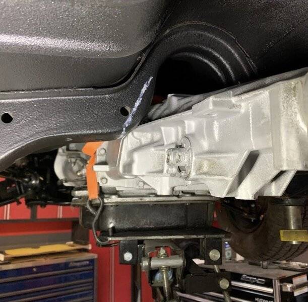

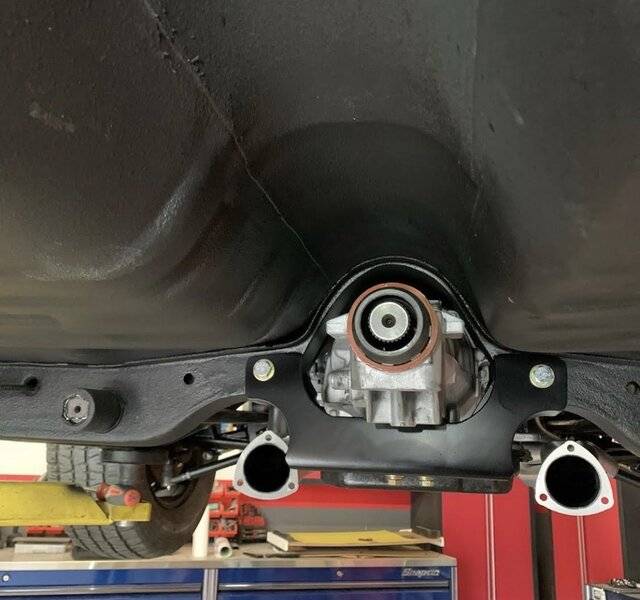

Here's the tranny mount
Looks great, color is excellent. I really like darker colors on these cars. Engine looks right at home, too. What is that radiator, looks beefy!
Thanks Funknut
It’s a Griffin Radiator from Bouchillon Performance
