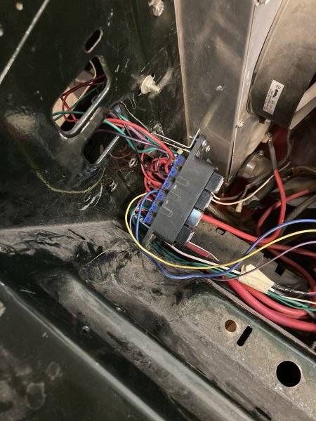

Thanks guys, I guess I should have specified, that picture of the engine bay is from a couple of years back It’s basically empty again now other than the engine and some loose wiring. We’ve been tinkering on it a little bit here and there. I was just barely able to squeeze under the car on the floor and hook up the neutral safety switch for him and the last 2 nights he’s been trying to decide where to mount a fuse block he had made. He had it mounted right in front of the battery originally just behind the drivers side head light but it’s since been removed and he doesn’t know how he wants it. I almost thought about just mounting the battery in the trunk and buying a fake battery and putting the fuse box inside of it. Maybe a post in the air and fuel section would get more views or electrical and ignition?
This is the fuse box in question and the general area he had it for the first go around
If the fuse box has a cover, I'd mount it under the battery tray. Orientate it so you can feel the fuses and pull each out to inspect when needed. There is the tar/fabric style wire covering available online and, in my area, CarQuest, that you can run wires through to keep it looking somewhat factory. If you're not pinching pennies, long wire runs, routed out of the way, covered n then shortened once routed.
