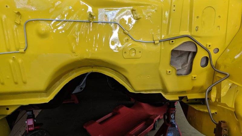

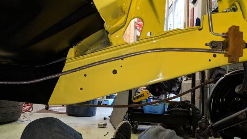

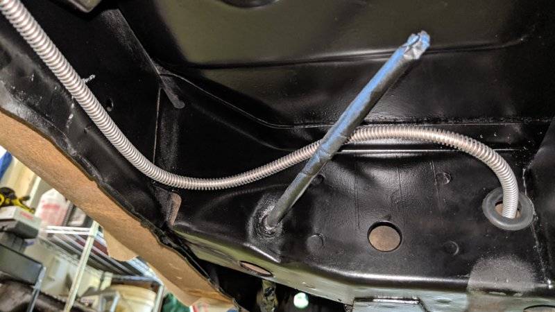

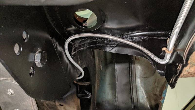

Decided to run brake lines next, front set are off the shelf from Right Stuff,
they fit "ok" but I had to manipulate them pretty hard to get them to fit. Of
course I didn't have old ones to use as a template so that could have been part
of the problem. Due to the subframe connectors, I ended up fabricating my own
lines using copper nickel with stainless "rock guard", very easy to work with.

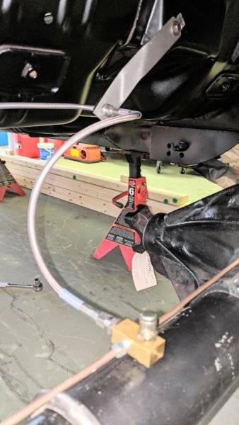

Since this was not a stock Dana, I ended up using a DOT approved hose to get
over to the block on the differential. Much later on I found that this will have to
change as the hose runs right where the exhaust is going to need to "up and over"
the axle. Doh!
