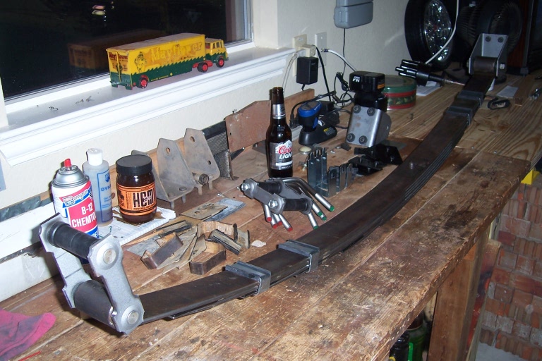

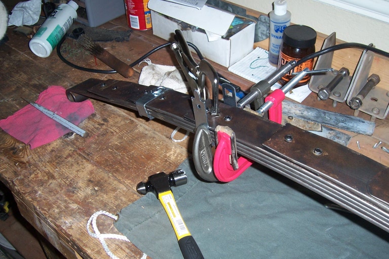

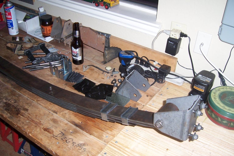

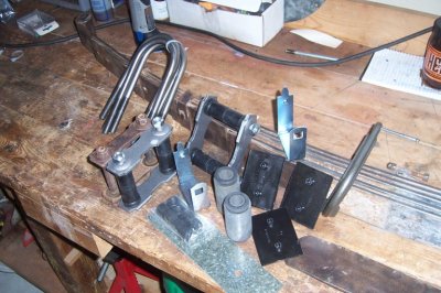

You'll see some of the parts to the rebuild kit, the new U-bolts, bushings and rear shackles.. I just cleaned up the individual leafs by hand with a wire brush, didn't want to put them through a blaster. I treated them with a clear metal conditioner for corrosion control. Ignore the U-bolts in the pictures, those were the MP products at the time and were too long. I eventually bough proper ones from Roger Gibson. But, think Jaime below has the proper ones too.
I found the rebuild kits online ( ebay I believe ). But, Jaime at http://www.megapartsusa.com/ has everything you may need ( wish I would have known about him then ). Do a search on "leaf spring" and you'll get all sorts of parts, including the proper looking shackles.

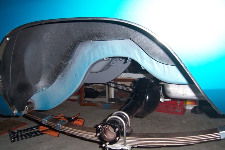

My research showed that in '68, the leaf springs were natural. They were painted black until '69. My former '68 Hemi Charger R/T was an unrestored car and the springs showed no signs of black paint. here's a little of what I did.

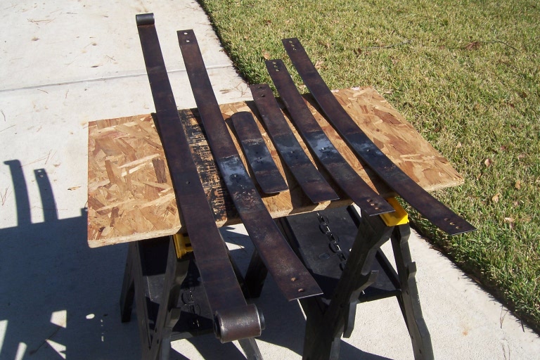

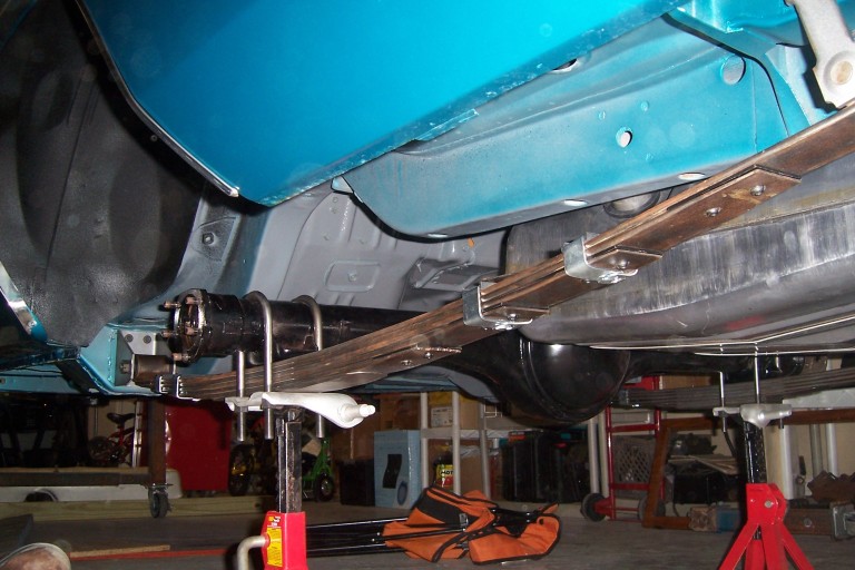

image.jpgimage.jpg As requested. The car has been lowered for this pic with spacer blocks and the front bracket. The leafs are original though and not sagged out. I recall that I did install new bushings in the front though. The lowered look is to go with the 18's & 20's.

Troy, Those pic help. Was there a difference between the driver and passenger side as shown? My 383 RR did not come with a Dana originally, but has one now with the same set up as yours. Were there less springs with non hemi or Dana set ups? G
G,
Yes, the leaf springs on a 383-equipped car versus 426 Hemi are different. There was a difference from left to right on the XHD leaf springs on 440 and 426 Hemi equipped cars. Is your Dana perched on 383 HD leaf springs or 440/426 XHD springs?
Pretty sure the standard springs would have been 5 springs each and the hemi would have had 6 on one side and 7 on the other. This included the half springs.
Looking at my photos and my Daytona in the garage......,
driver's side:6 full leafs
passe's side:5 full w/ 2 halves
