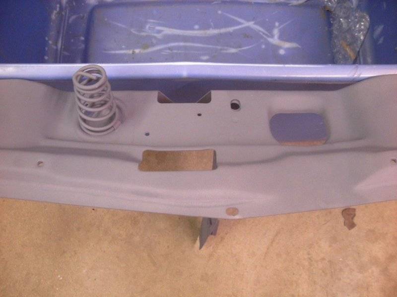

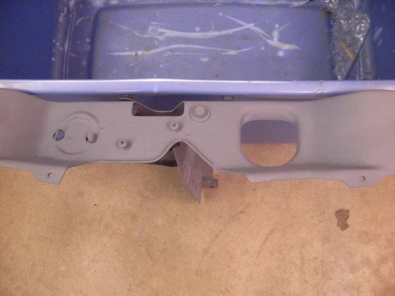

FYI here is 68 vs 69. Someone hacked a 69 onto my 68 before I bought it.
View attachment 665750 View attachment 665751
Thanks for showing the comparison. I put a late 68-69 Roadrunner hood on my early 68 Sport Satellite. I used the early 68 header panel , but we had to move tha D shaped hole over a little to the left in order for the safety catch to line up. We used the stock early 68 hood release. IIRC we had to bend the hood release lever down gust a bit, as I replaced the GTX style grill with a Satellite ( roadrunner)style grill. The body man may have done some very minor tweaking to the hood latch parts, but he did not move any of the threaded mounting holes........MO
