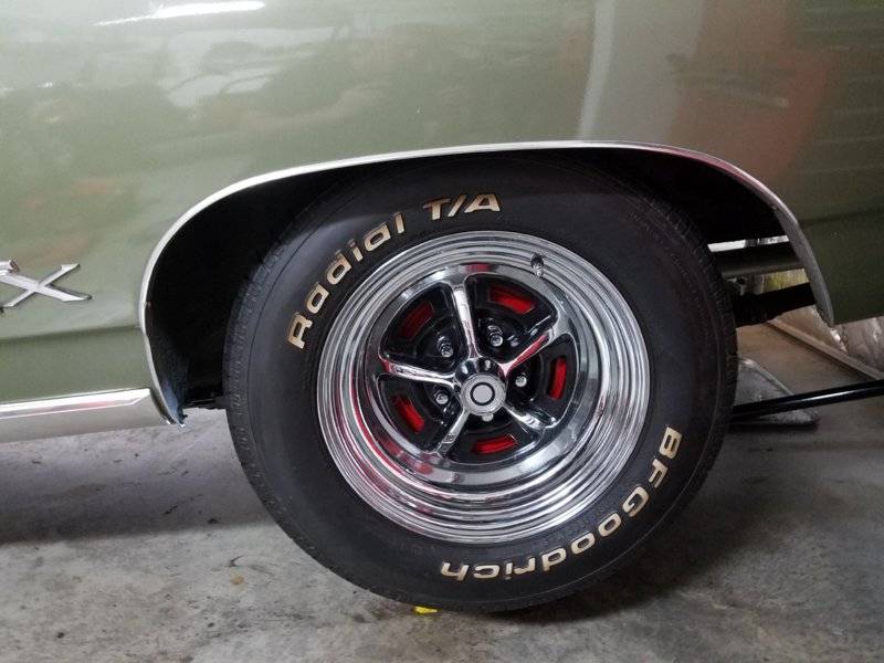

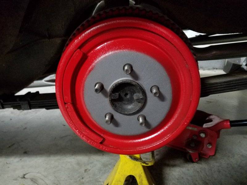

So one victory. Oreilly brake best drums worked out fine. Thanks for the info.
Wojo68, it was an adventure. Pretty sure nobody makes the 68 style smooth 11 inch drums so take care of the ones you have. If not, here is one of the options that i can verify that fit. 2953DGS from oreillys

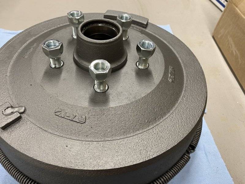

I needed a front drum for my 68 RR and lucked up and found one with a hub assembly for $50. Here is the pair after they were blasted, turned, painted, and new studs installed. These are getting hard to come by.
