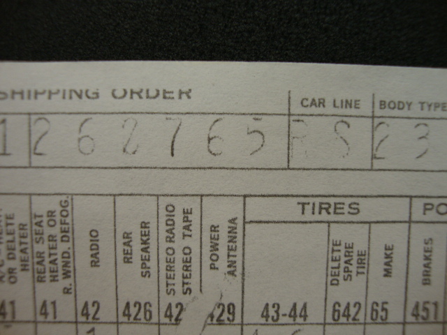

Shouldn't some of the fender tag numbers match with some of the VIN plate ?

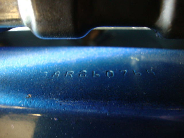

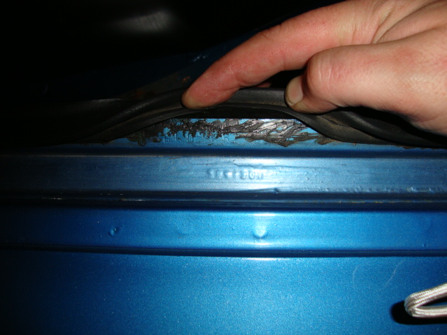

And where should be the hidden VIN tags or stamping numbers in a 68 GTX
in 68, the hidden stampings and the fender tag number refer to the Shipping Order number found on the broadcast sheet, not the VIN
one is located on the radiator core
and the other one the driver's side trunk lip under the weatherstripping
& the only way to tie a vin # & body ,fender tag # together is with the build sheet.
but the VIN was partially stamped on fender tag since 69, Am I right ?
