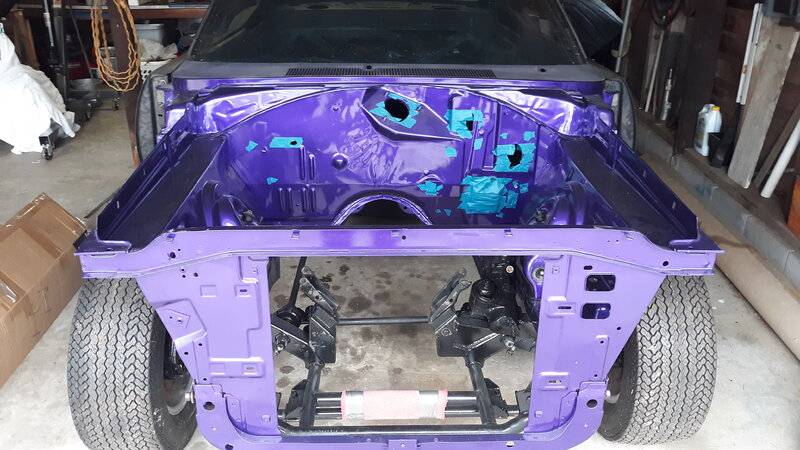

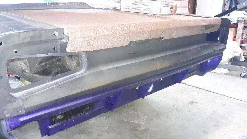

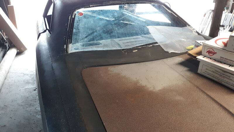

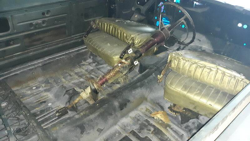

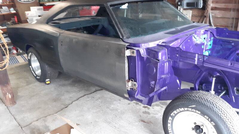

Well I just picked this up the other day for a relatively cheap 13k.

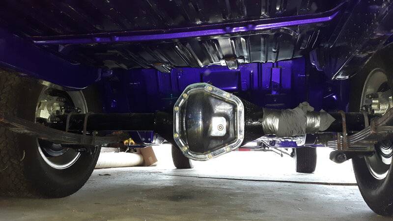

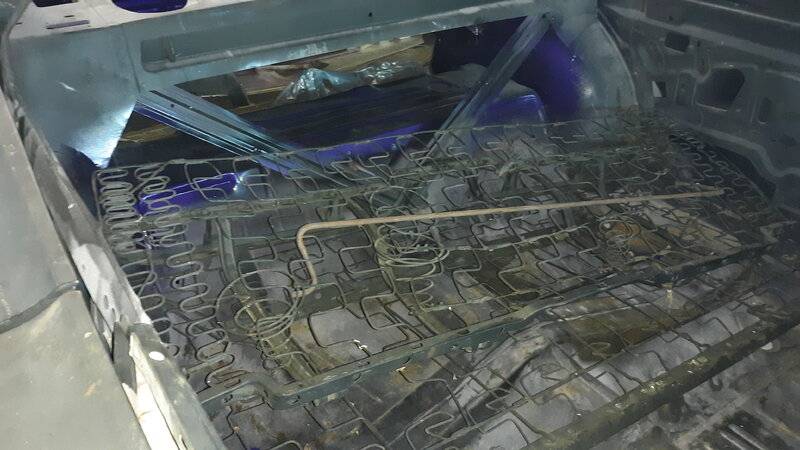

Mostly complete car that had a rotisserie started on it by a professional shop back in 2006/2007 so the metal that was replaced wasn't that cheap China stuff that's everywhere today. There were quite a few extras that came with it and many parts to convert it to R/T but we won't be adding any badging to it because the inside of the trunk has already been painted and I don't want to mess that up by welding the "DODGE" holes closed to add the holes for the R/T finish panel. We have most of the "CORONET 440" quarter letters and only missing a "D" for the rear panel. The rear seat frames were blasted and painted already. Brand new white seat covers, foam, insulation and headliner came with the car. Dana 60 Strange axle, tubular upper/lower control arms, k-frame, 4-wheel disc brakes from Reilly Motor Sports(back in 2007 and no longer carry the parts) all already loosely installed. A 1978 RB 440 block that we're having built by a local engine builder who said he'll get all the machining done, take all the proper measurements, etc., and build to push around 600hp for around $1,500 and no more than $2,000, which will include boring and bigger pistons, upgraded performance cam that will chop and thump the roads. Said he lost count of how many engines he's built after about 700 so he knows his stuff in that realm and a few race cars in his shop. We have the original 120mph gauges to go in the original dash but also have rallye gauges with the clock instead of tach. I read in a post on this site that the only modification needed to convert to rally gauges were adding the two tabs at the top without any other cutting necessary but can't be too sure about that so that will be a later decision. I've got a photo book that came with it of the progress the hot rod shop did on the rotisserie as well as all their invoices, totaling over 32k in parts/labor. The original fender tag, dash VIN, broadcast sheet(in pieces and brittle with some parts still legible including most of the VIN), window sticker, original owner's manual, and a sheriff's form for the title, with the title as well, all were included. I believe we got a good deal but it's going to be quite a journey still before she's on the road as this is our first Mopar build as a father/son project. I'll try to keep documentation and photo evidence of work going forward and will be posting to this thread. Will also be selling parts we don't need and older ones we won't be using and got a few already listed on site. I've done researched quite a few of them and will be expecting reasonable prices as I suspect some folks are already trying to downplay them so they can snatch up and sit on their shelves. I'm not looking to screw anyone over and I'm expecting the same in return. Thanks, FBBO, a lot of the people here have been welcoming thus far. Looking forward to learning new things in the Mopar world.

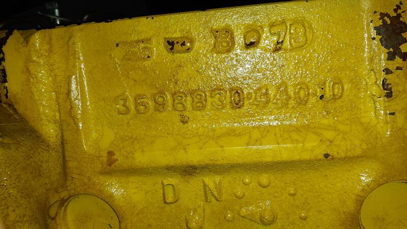

Whoever decided to paint the block yellow was on something back in 2007 because everyone I've talked to so far doesn't really care for it so it will be Mopar orange when done. And yes, I'm aware that all 440's came turquoise other than the high performance/police package cars in '68 but I think 600hp when we're done having ours built will be pretty damn high performance for the street.

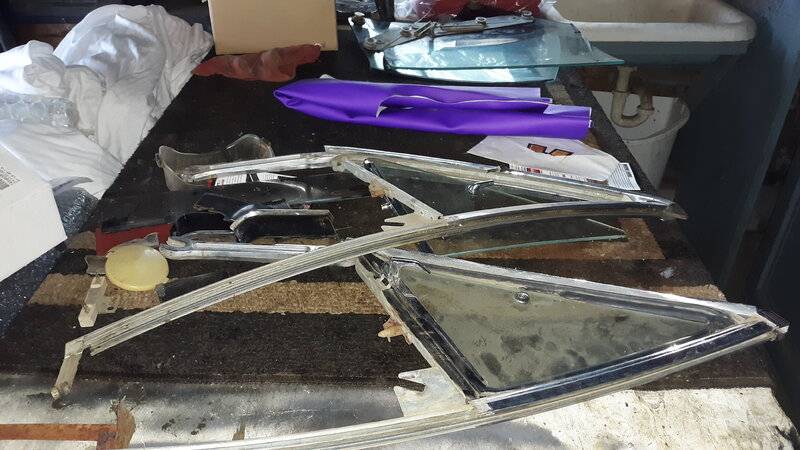

Assembling someone elses failed project sucks.. I did it and nothing was bagged and tagged. Boxes of parts and nothing in order. In the end though it was fun. Hardest part to figure out was the vent windows and all the mechanical crap in the doors. I ended up just laying all the parts out on the floor and started putting puzzle pieces together.

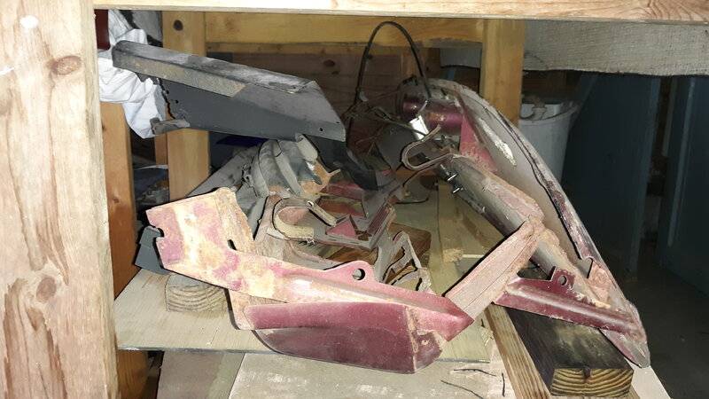

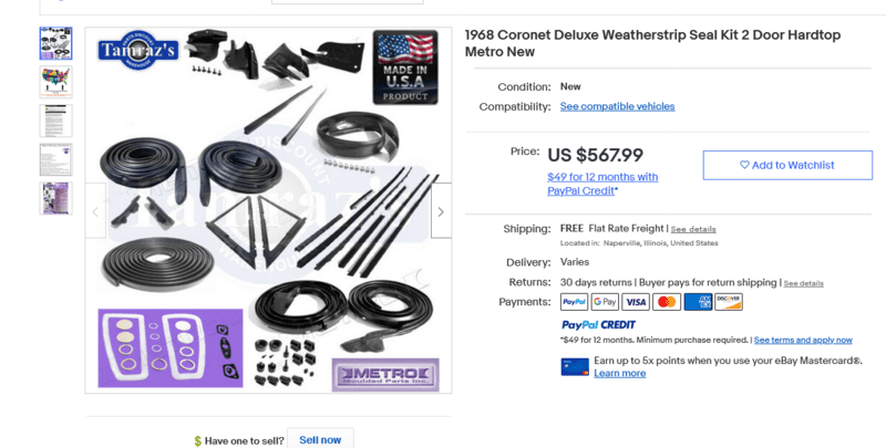

Yes sir, it's going to be a difficult task for sure. I did notice that they labeled the window mechs with "R/L" but figuring out just exactly how they go in will be another ballgame. They also labeled the little weatherstripping pieces of where they go too but we'll be ordering those new, which I believe this link is the correct kit we'll need(someone correct me if I'm wrong on that before I waste $568 on the wrong kit): https://www.ebay.com/itm/1968-Coron...eal-Kit-2-Door-Hardtop-Metro-New/392563515082
It's got my dad excited about getting to do a Mopar and drive it when it's done so that'll be worth it to me to go through all the undoubtedly future headaches. He's had a few Mopars back in the day when he could get them for just a couple hundred bucks like a Demon, Goat, Belvedere, and I think a '67 Charger (can't remember the exact years off the top of my head but he knows)
Looks correct to me. If you want good info look for @dadsbee build info that man did an amazing job recording the build with lots of information and photos.

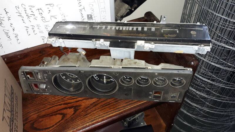

You're comment about converting to the Rallye cluster might be over simplified. Maybe just a little bit of fab work to get it installed in a bare frame, but then there would be fitment issues with the pad, etc. I don't know much about it, but maybe you could use reproduction Rallye dash pads?
I think most people that have thought of converting end up making aftermarket gauges fit in the existing hole, or go with a Dakota Digital cluster.
I'm not sure. I was going by what @paulie-rt said in this thread, https://www.forbbodiesonly.com/moparforum/threads/b-body-rallye-pack-dash.233487/
Said he did the conversion on a '68 500 vert and the only thing he had to adapt were those two tabs that held the gauge cluster at the top. I also have another set of the 3 piece dash pads in black for the rallye gauges along with a few pieces of trim that came extra with the car. According to the guy's ad who I bought the car from, he said most of the parts to convert to an R/T had already been purchased and were with all the extras in the sale. I just need to figure out how everything goes together and what all I have first. Not entirely sure I'll be using the rallye gauges as I've got the original 120mph cluster and one of the prongs that goes into the back of the rallye's pops out which will need to be re-soldered and not sure if that will screw up the circuit board.
If you do convert it, post pics and a little "how to" write-up if you don't mind. I'd be curious to see what all is involved.

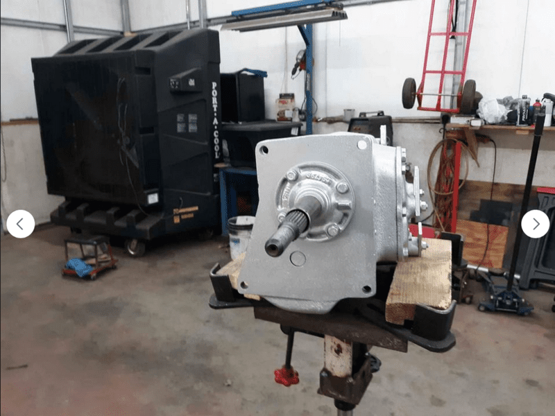

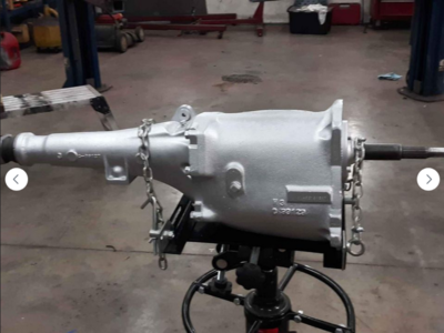

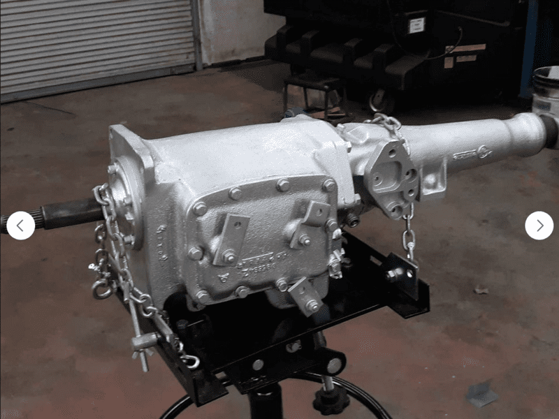

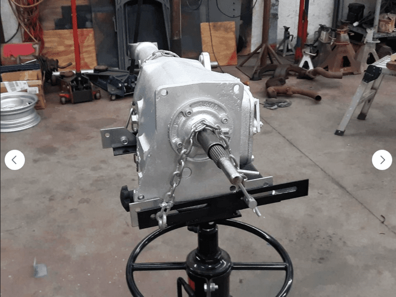

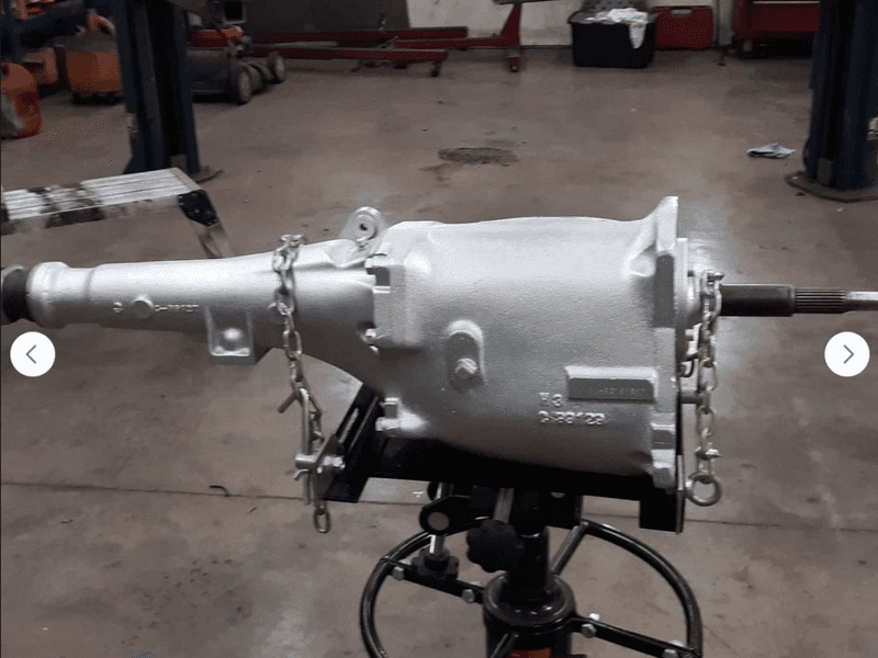

Well I stripped down the dash today and tried to see how the rallye gauges would fit in and it would require cutting the bottom of the cluster area out as well as adding those tabs. I won't be doing that so those Dakota Digitals are looking pretty appealing for the look, simplicity, and basically plug'n'play. On to the next issue, if anyone has a good recommendation on the best 4-speed transmission to go behind a ~600hp 440RB and a Dana 60 rearend with specifics on parts, I'm all ears. I've been looking at the 833's and my father really wants to have a pistol grip shifter. We've also decided no console will be going in. Keeping lowest price possible in mind.
I'll be needing...
-Pistol grip shifter (non console) that will work with '68 b-body
-Correct shift box/linkage
-Bellhousing
-Clutch assembly
-Clutch Pedal assembly/linkage

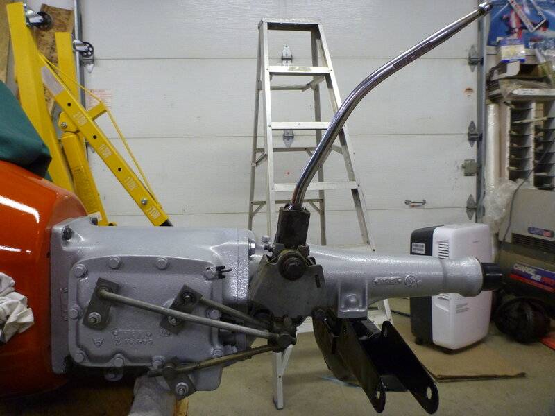

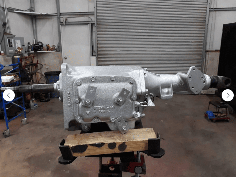

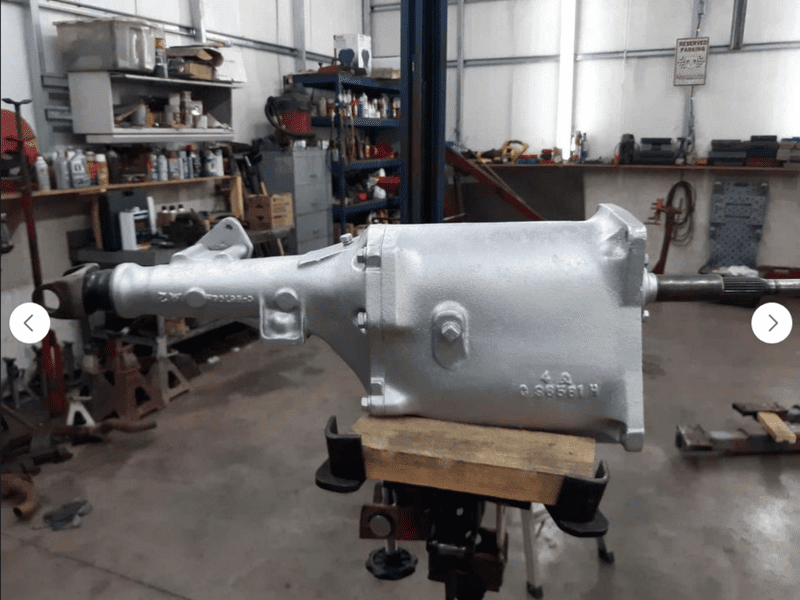

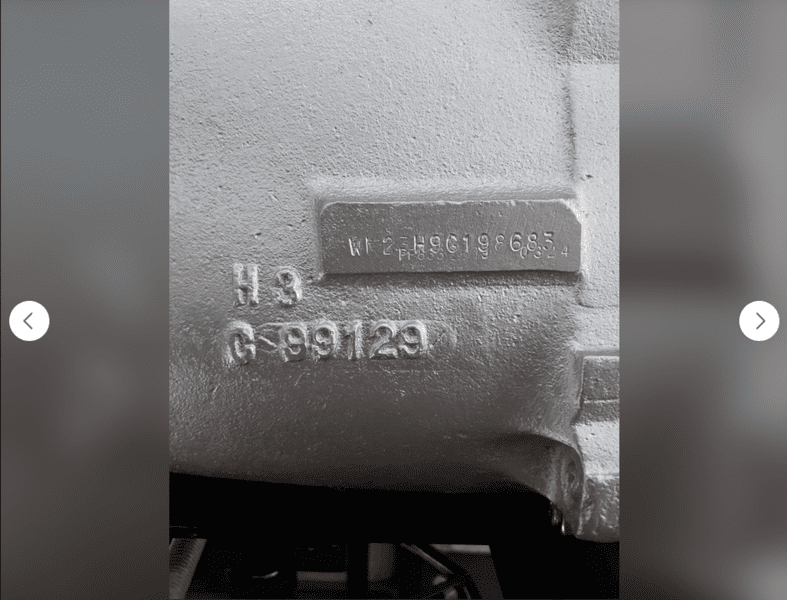

Before I screw up and travel 450 miles round trip, will this A833 work for my ride? Signs are pointing to no from what I've gathered regardless of what the guy said so I'm needing a second opinion(fact) from an expert, thanks.
That's an abody ?
No....
...what you need..
Thanks, @dadsbee . I just changed my search parameters and actually found the exact same guy we were going to meet and it's $100 cheaper than the one I posted above! Holy ****, talk about lucking out. You've got a hell of a build by the way. I'm on page 7 of your '69 build thread and I'm highly impressed with your work.
