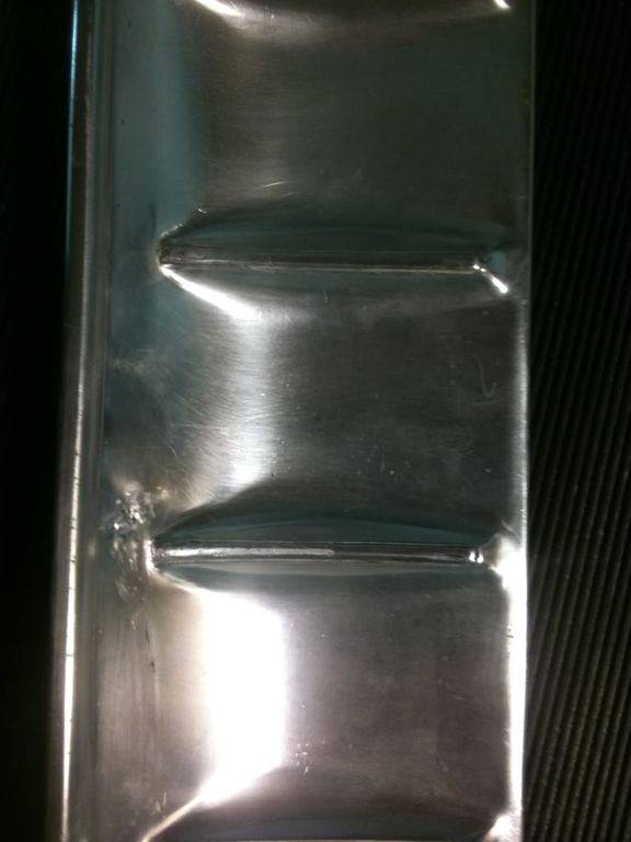

After stripping the paint and putting thru the polishing wheel. I tapped out the deep dents, but as you can see, they're was some definite TLC needed.

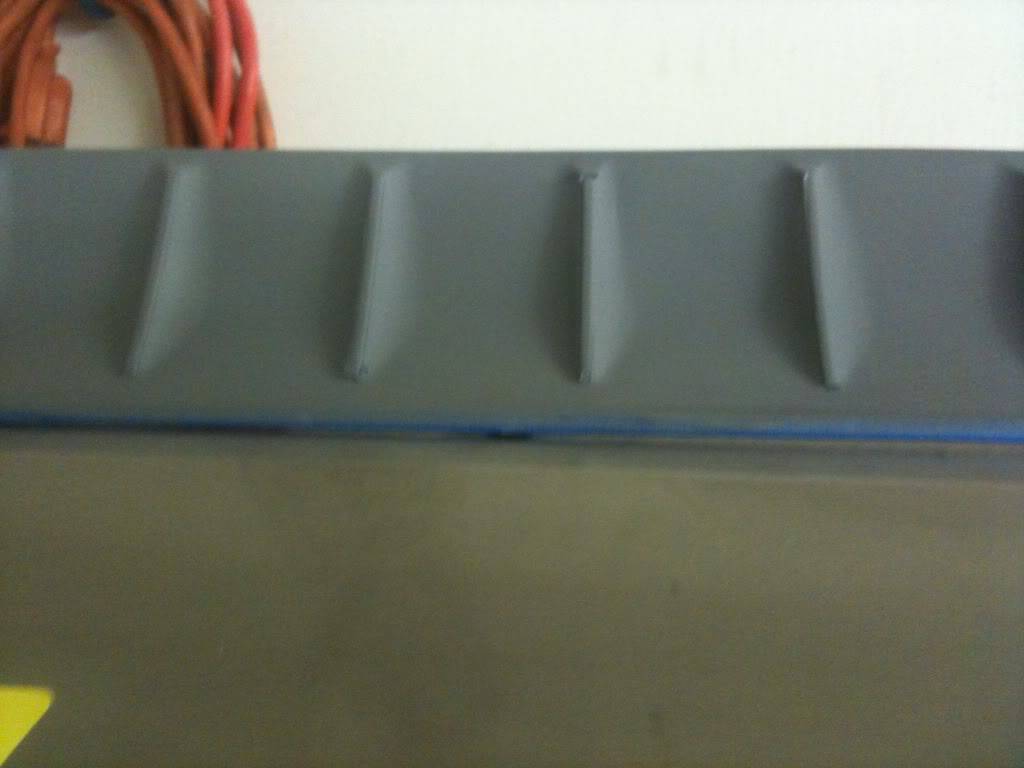

Looks like a lot of filler, but 90% or more was sanded off.
After priming and fine sanding.
