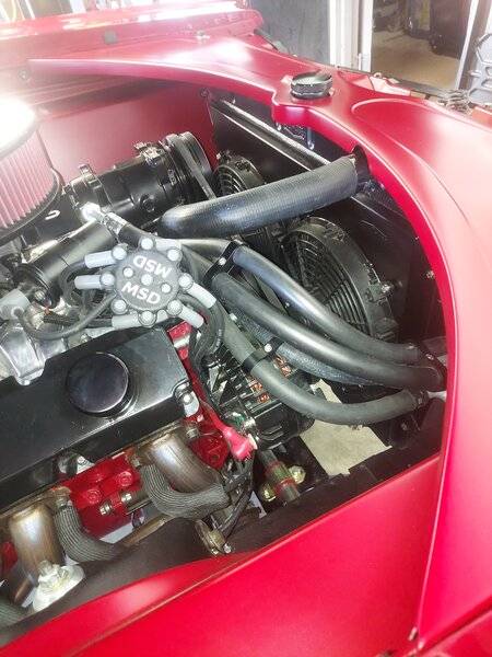

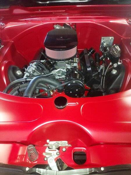

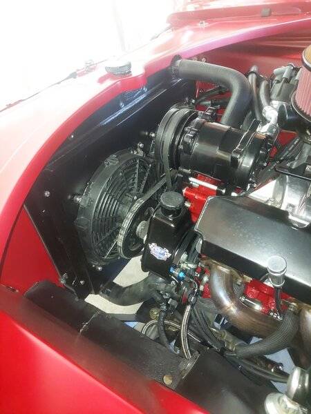

This topic has been out there a long time and my problem is similar to many others, how hot is too hot? Many different thoughts on this and I realize different conditions can have an effect. I personally am a 200 max guy. Over the last few years have been through various 22" radiator, shroud, and fan (electric & mechanical) combo's with basically the same results, too hot, 205 down the road, 220+ at idle. Can't even think about running the AC. This is a typical August day in Southwest Ohio, upper 80's with close to 70deg. dewpoint. I've checked this with my hand held temp gun, pretty close. Engine is original 383, .040 over, head and valve train work, comp cam (.230/.236 @ .050), AR stainless headers. 6AL box, MSD billet dizzy (no vac. adv.), Holley Terminator Stealth EFI, Tremec TKO 5 spd. Timing 14deg. @ 950 idle, AFR 13.7.
During the pandemic went through some upgrades and mods which included the Tremec, Terminator, Dakota Digital, cleaned up the engine compartment. Along with this I went with a Cold Case MOP754K 26in. 2 rows of 1.250in. tubes, 16 fin/in. and dual 12in. fan kit claiming 3200CFM. Reviews on this unit are mixed from greatest thing since sliced bread to great radiator but ditch the fans. Can no longer find it as a kit on the cold case website, maybe that's a clue. Anyway, thinking on ditching the fans and going back to what Mother Mopar intended, that being factory shroud, 7 blade fan w/thermal clutch. I have 4in. of space so should be plenty of room. Before I move forward with anything I'm open to input, comments, advice. BTW have a couple of nice 22in aluminum's come get them! 3 pics. Thanks Dale.

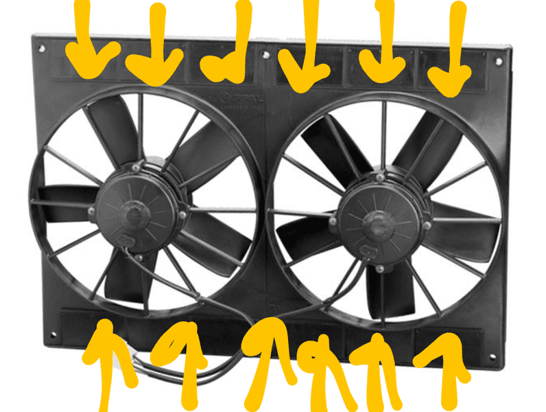

The issue for some w the 2 - 12" electric fans w shroud not cooling effectively on highway is the open area. 2 - 12" fans have only 226 Sq inches of space and a "flat" shroud that creates too much turbulence at highway speeds. Mine would get over 220° w electric fans n shroud at 80mph in my above setup. A factory shroud opening is about 20" and has an open area of about 314 sq inches. This allows much more air through and is also curved inside allowing air to flow smoother.

I went back and read his post, that's a good point and another reason to buy a quality unit. The unit I bought incorporated vents/passthroughs.. whatever you want to call them to address that issue. They have rubber flaps that work like check valves, at freeway speed they push open and allow additional airflow to pass through but at idle the pulling of the fans holds them shut.

I went back and read his post, that's an good point and another reason to buy a quality unit. The unit I bought incorporated vents/passthroughs.. whatever you want to call them to address that issue. They have rubber flaps that work like check valves, at freeway speed they push open and allow additional airflow to pass through but at idle the pulling of the fans holds them shut.

I had the rubber flaps over almost every available space that wasn't the fan. It may just be my car, I've read many that work, but not in my heat. The explanation I was given was that the flat shroud causes a high pressure zone, keeping air from coming in at highway speeds even w the flaps. A louvered hood, raise rear of hood etc than help creat a low pressure zone would help suck air through at highway speeds. But for my car weren't an option.
