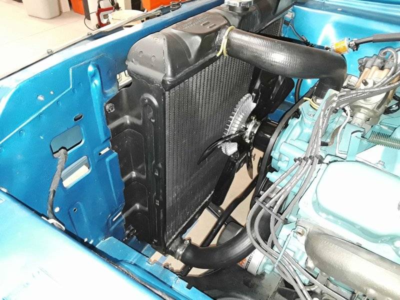

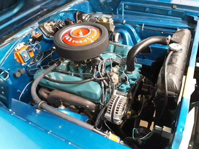

Long story short, I changed to a clutch fan on my 68 Road Runner (383) and now it starts to overheat if I idle around too much. I know I could try to get a fan shroud that fits and maybe a bigger radiator, etc. But I like the way it looks under the hood now and don’t want to change it.

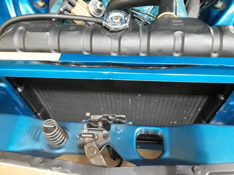

I just want to add a thermostatically controlled electric fan in ‘front’ of the radiator. That should more than take care of the heating problem and allow me to keep the stock looking engine bay (in back of the radiator support). But I noticed the radiator fins (in front) are in set back from the radiator core support about 2.5 inches. So I’m not sure which elect fan I can buy that can mount in front of the radiator and yet set back a couple inches to be closer to the radiator fins.
Has anybody encountered this before and do you know if they make electric fans for ‘in set’ mounting to the front of the radiator? Which manufacture is best? As always, huge thanks for any help and advice. RRDon
I want to keep this clean, uncluttered, basically stock look under the hood.

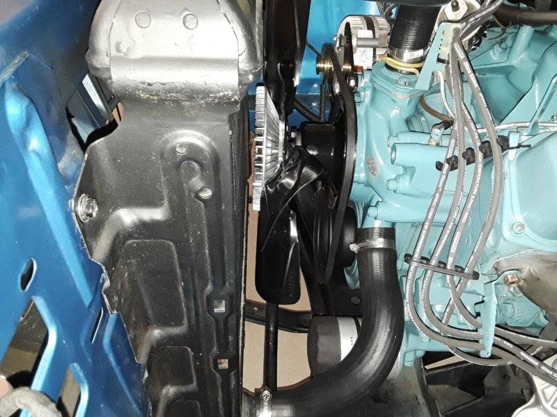

there's no mounting on the sides of the radiator for a shroud. I tried to find some but the kit I got doesn't work with this radiator. Frustrating. That's why I just want to put an elect fan in front and be done with it. ;)

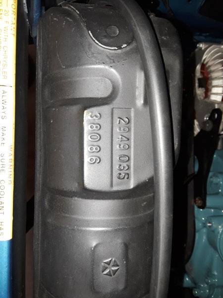

My radiator does not have provisions on the side to mount a fan shroud. If you know of a fan shroud and a mounting kit to attach it that will fit on my radiator please let me know because I have not been able to find anything yet. I could buy a whole new radiator and order it with a fan shroud I guess but I really would like to do something simpler.
