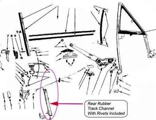

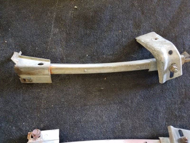

I used a picture like this one to figure it out. Turns out i had to find a driver door rear channel the one that was in the box of parts was for a 2 door hard top and the channel was wider. found this one on ebay. HERE

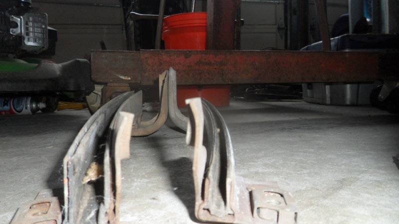

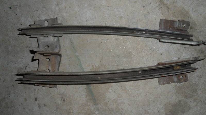

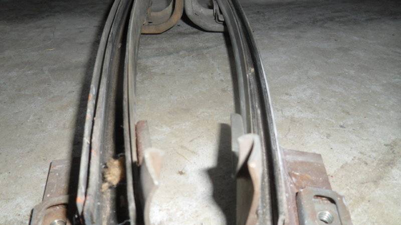

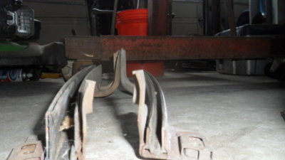

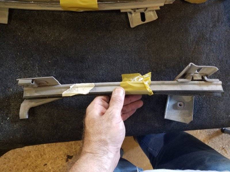

That is a left door track for a POST car.. Just making sure you have a post car. The 2 door hard top cars channel is wider. These are the ones that were in the box of stuff. The wider channel is for a 2 door hard top the skinnier channel is for a post car. I still have the wider one if it turns out you need it let me know. This is the driver side rear.

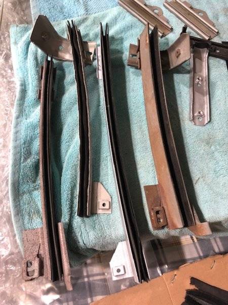

Thanks. I checked and have four different types of channels that came with the car. Based on the pictures, I believe the correct one is on the left. The problem is that I bought new windows and the skinny channels on the left side of picture do not fit on the windows. The new windows came from AMD and are for a post car. When I slide the channels along the back side of the new windows, they really bind up and get stuck. They slide smoothly on the original windows, but the originals have deep scratches in them and cannot be reused. I called AMD and they said they have never heard of this type of problem before. I laid the old and new windows on top of each other and the new windows have a slightly different bend so the channels bind up. Very confusing....
The AMD reproduction door glass is slightly thicker than the OE glass and has been a problem with people using the reproduction mylar glass channel runs that attach to the front leading edge of the door glass. I have not heard of an issue with what your experiencing, but could see it be putting extra stress on the glass if not properly aligned. One other thing is that you may want to look at removing the liner that is in the channel. They are held in place with two rivets. It appears that yours is puckered in several areas putting more resistance on the glass. Just remove, clean the channel and glue back in place so that the wrinkles are removed. If the flocking is severely worn, the channel run is reproduced which the new flocking will make it slide easier, but may be still a bit tight as it will not be worn.
