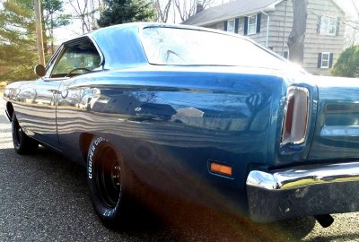

I have 275 60 on my rear...stock suspension, drum brakes, 69 RR...wish it looked a bit wider, but didn't want to give up the height of the tire.
