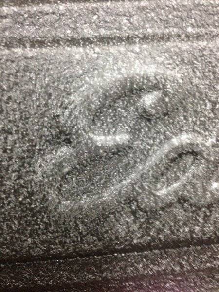

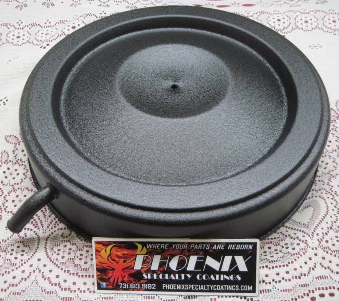

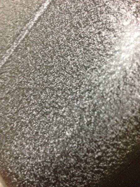

No photos of OE,
but I refinished mine by rattle can. Spray it on heavy and use a hair dryer on hi to give it more wrinkle.
For what ever reason they do not photograph well. Looks way better in person.
This photo the air cleaner color looks way off but in person it matches the valve covers dead on.

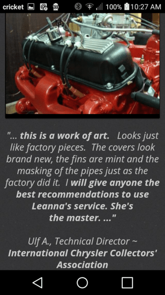

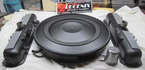

I chose to add this black wrinkle powder to my arsenal since it most closely resembles the factory finish. I have used it for dozens of customers on daily drivers all the way to world-renowned "famous" rides, including a set of Commando valve covers for the Technical Director of the International Chrysler Collectors Association's Dart Charger. It's very popular!

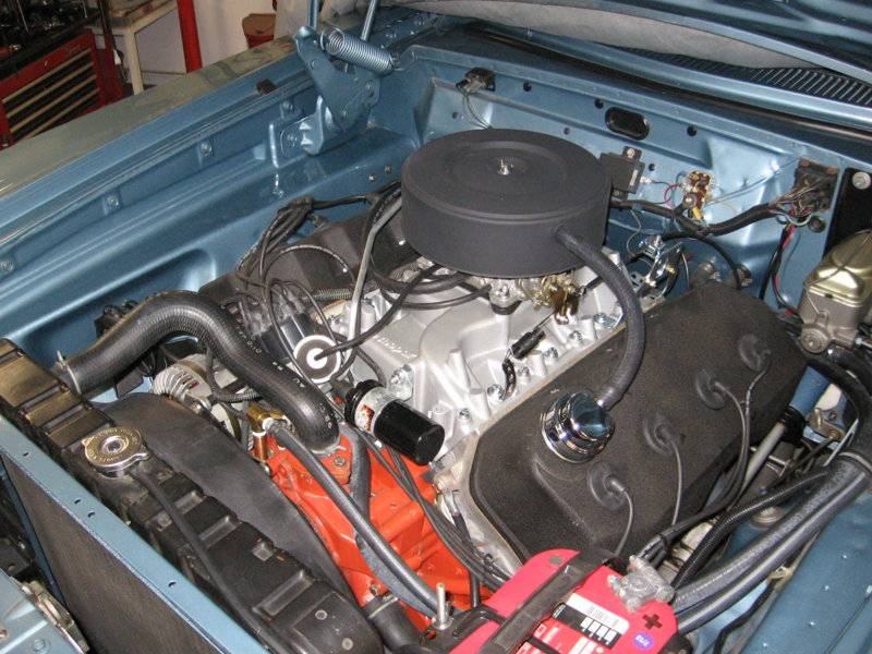

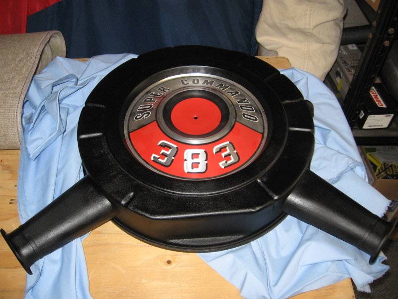

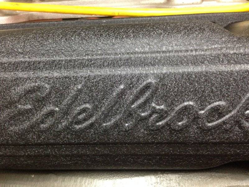

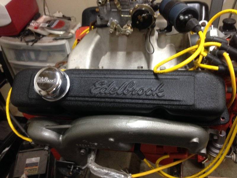

I used teh Eastwood stuff on my 67 440 air cleaner a few years back. Turned out perfect. I'll add a pic in a bit
