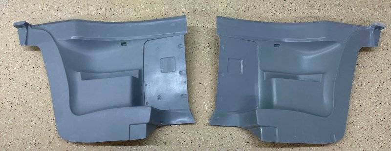

Anyone know of a reference or list of whats swapable from these years? Would like to change interior colors, but all new stuff is crazy expensive.
For Satelite/Road Runner convertibles, the front seat everything is the same as hardtops/coupes....seats, door panels, consoles...all the same. In the rear seat area, the rear seat is about 1ft. narrower (rear seat covers different than hardtop/coupe) and the rear interior panels are unique to convertibles. The 68 rear/convertible interior panels have round holes for the rear interior lights. The 69 & 70 rear/convertible interior panels has rectangular holes for the rear interior lights, but otherwise would physically fit. These are stupid expensive, not reproduced and hard to find. Best bet is to repair what you have. The actual "interior panel insert" (what you'd buy) for convertibles is different in the rear too. Basically, the whole back seat area is convertible only.
66-67 have the round side rear seat light. 68-70 have the square hole. I have both types of fiberglass reproduction panels available. 68-70 parts are interchangeable. you can only get them one place.
