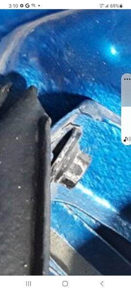

Would it work better if the cam bolts were tight?(see orig pic)

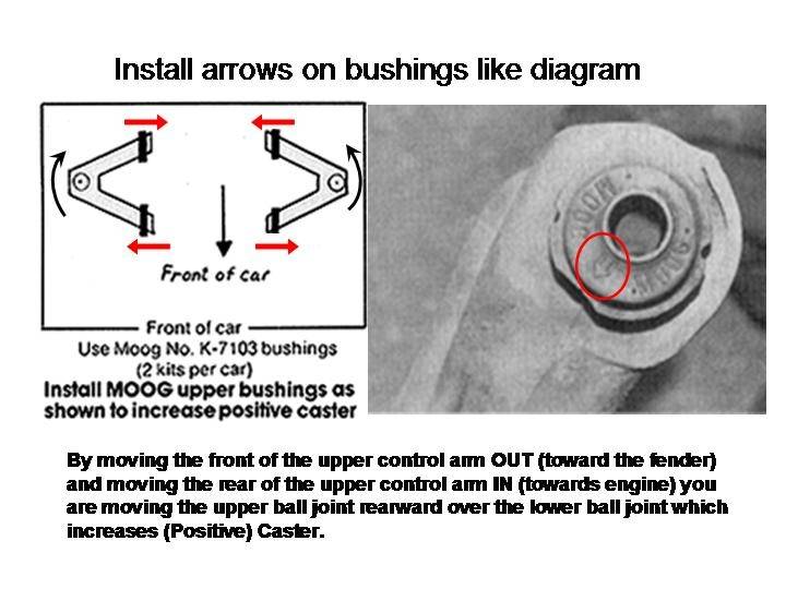

you want to install K7103 Moog Offset Bushing that allow for more positive caster.
If you installed them like the instructions in the package they might not help you much. The Moog intention of the bushings are for rusty cars that have sagging frames that bend inward over time.
The "trick" is to install them like this diagram below and ignore the Moog instructions. The arrows will be pointing opposite directions front bushing to rear bushing.
First make sure you set the ride height first to what you want. Factory manual alignment specs are no good for radial tires, they only work if you use bias-ply tires. For Radial tires, Camber -.50 to 0 degrees, Caster as much positive as you can get up to 3 degrees and toe in 1/16th to 1/8th inch. Car runs down the road straight as an arrow now. You will be limited to what you can do with stock A arm bushings, but if you have the Moog off set A arm bushing you can tweak it a little more.

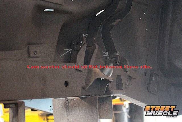

I see I got red x'd ! What are we looking at here anyways?View attachment 1226814
The cam bolts are NOT loose. But I can see how you might come to that conclusion. The rubber bushings have dried out and crumbled over all the years and mostly fallen out. I've taken up all the slack possible. Red x simply means I 'disagree' with your assumption. Not meant as an affront to you.
Looks to me like the cam is not sitting inside the square, should be flat against the inner portion. The cam uses those ribs I guess you can call them to adjust the control arm. The picture you posted look like the cam is outside of those ribs.
