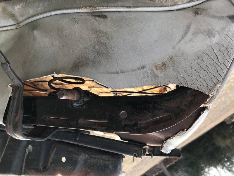

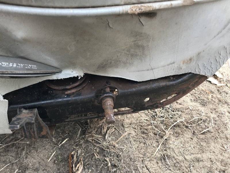

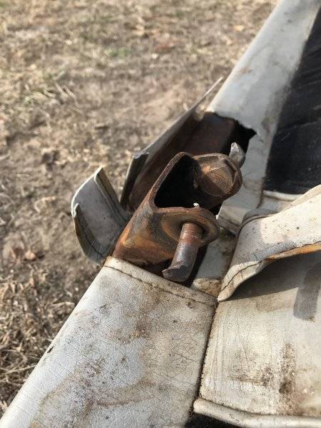

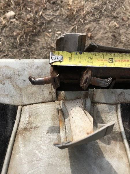

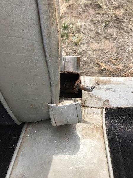

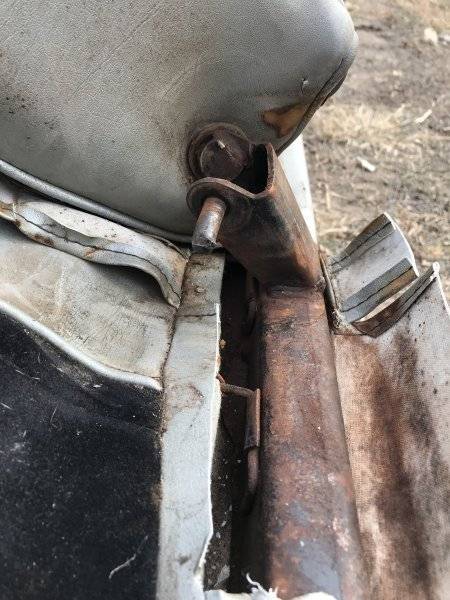

I have been unable to find a 2 door bench seat for my '69 Road Runner in my area. I have a very nice '69 4 door bench seat and I also have the backs of a '69 2 door bench seat. My question is, has anyone converted a 4 door bench seat to a 2 door bench seat with some welding/fabrication? What would be really helpful is a picture of how the 2 door bench seat backs attach in the middle of the seat at their pivot point. It appears as if there should be some studs in the middle of the seat bottom that the backs slide on to but I don't know for sure.
I think it would be fairly simple to just bolt up the hinges on the sides and create a stop for the backs on each side of the seat bottom. So, that part doesn't concern me as much as how the seat backs attach in the middle of the seat.

These are from a '67 Belvedere II and should be similar to what you need to do.
Center hinge.
Side pivot.
edit: added a couple more pics.
Great, thanks a lot for the pictures. That helps tremendously. After seeing your pictures, I think making a 2 door seat out of my 4 door seat and my extra parts will be doable with a little fabrication/welding.
