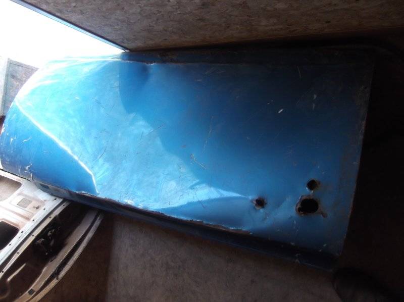

Is there a difference between a hard top door and a convertible door other than the vent and door glass? I have one that is banged up and wondered if it is worth saving. Thanks in advance Randy

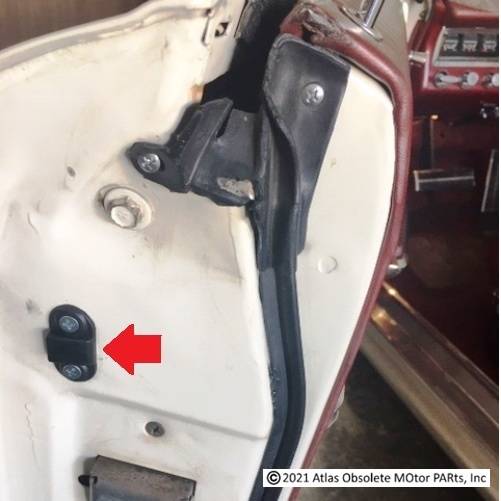

There’s also an anti rattle/sag piece on the back of convertible doors that contact a spring mechanism in the door jam. Definitely save this piece if in good shape.

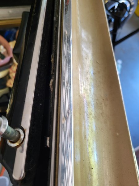

My 70 satellite convertible has an interior belt molding trim piece that runs along the inside of the window on the top of the door that my other b bodies don’t have. Not sure if this is due to trim option differences or convertible specific.
My 70 satellite convertible has an interior belt molding trim piece that runs along the inside of the window on the top of the door that my other b bodies don’t have. Not sure if this is due to trim option differences or convertible spspecific.
Does it look something like this?
This is on my 67 Belv II conv. My 67 Satellite hdtp doesn't have that interior trim. I don't remember if my 67 Satellite conv matched the Belv conv or the hdtp so I don't know if the difference is Belv vs Sat or conv vs hdtp, but suspect the latter.

Also, that trim piece on top of the door near the glass is “belt line molding” which is an option for hardtops and standard on convertibles

My 70 satellite convertible looks like your picture for the trim. The trim piece that runs by lock knob at the top of door is not on my 68 hardtop coronet but I do have the stainless belt molding that runs by the outside of the glass.

After closer examination it appears this door is not worth keeping. None of the internals for the vent window are there. Thanks for all of the comments and information.
That's not a convertible door... The convertible wedge was never mounted.. The holes aren't drilled..
