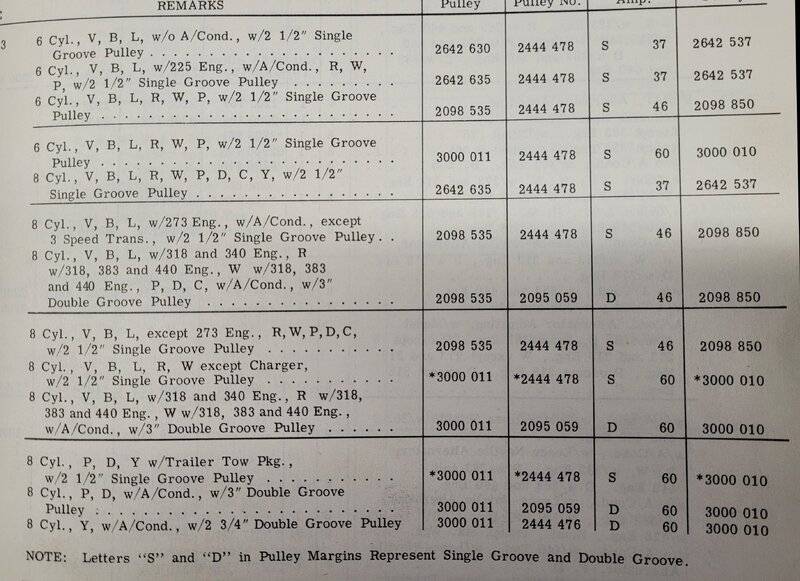

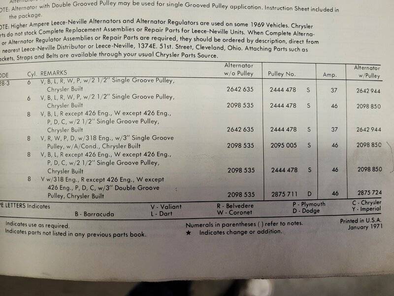

Here's the part numbers.
Alternator only.... pulley part #... and assembly part number. There is an obvious error on the 46A assembly as they give the same part # in both 1968 and 1969 for the 2.5" and 3" pulley assemblies, yet show different part #'s for the pulleys as should be.
1968

1969
Thanks for the info. Looks like #2875724 with double grove would be an a/c car? mu car non A/C so 2098850 would be correct. thanks again, that's what's great about this sight. So one out there has the info and maybe the parts. BE SAFE IT'S A JUNGLE OUT THERE
