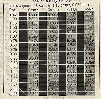

I think pretty much general consensus for a normal street driven car with radial tires. -.5 to -.75 degrees camber, 1/16” toe in and +3 or 4 degrees caster. Probably tough to get with all stock components unless you have the offset upper control arm bushings or aftermarket tubular or adjustable ones.
I rebuilt the front end on a Dart recently, with the offset UCA bushings I was able to get 7 degrees.... Car drives incredible...
NEGATIVE DEGREE caster settings? Gross.
My settings:
6* positive caster
1* negative camber
1/16 toe in
You wont get caster settings like that without aftermarket UCAs or the offset bushings, but the closer you can get to those specs the better your car will handle. It will surprise you...
