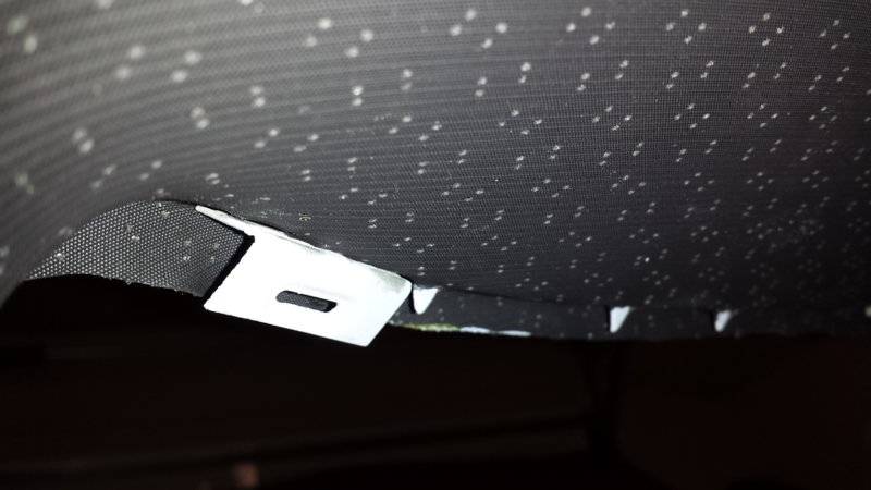

Anyone know how to best install these clips? I broke 4 of the 6 new ones I bought from Megaparts. As I understand it, these clips are pinched when inserted into the hole in the roof near the windshield. Any advice is welcome. The picture is just for reference...my clips are new.

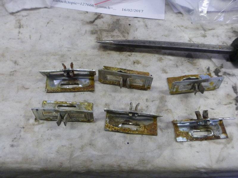

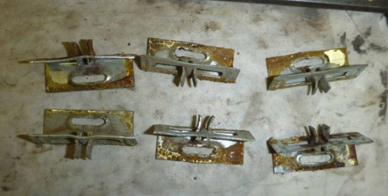

I just straightened my OE's and re-used them without issue.. also looks like my picture borrowed and cropped.

Yep, just a pair of pliers. Stick them in the hole and squeeze BOTH tabs at the same time to spread the other ends in the hole, no issues. If they broke, call Jamie and I bet he'll send you new ones!
