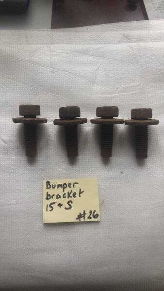

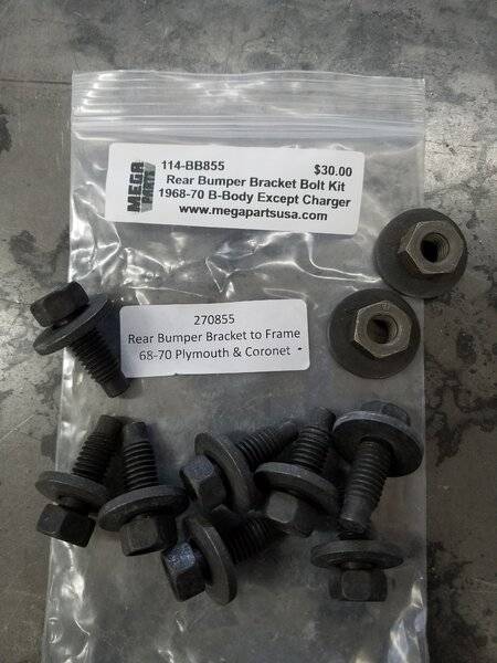

I have these factory bolts if you still need them.
Great, glad you found what you needed.
