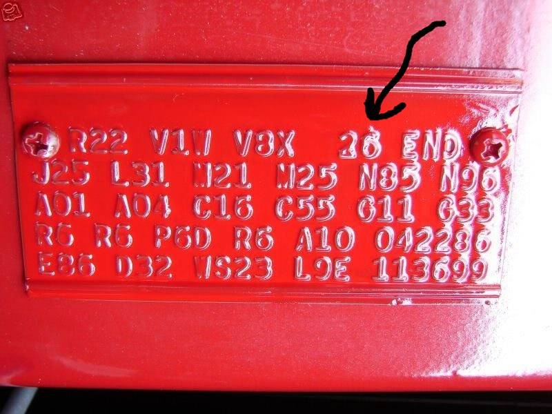

I think you mean 26" radiator. The last numbers on the fender tag should be 26, which is the size of the radiator. The big blocks were 26", and small blocks like the 318 were 22".

On a side note 69Bee, that must be one gorgeous R/T you have there. Sure would like to see it, but I'm really confused on the interior trim? Is it REALLY P6D? with the red exterior and upper door color too? Wow, that would be unique to say the least.
A 22" radiator was the stock size for a 383 auto/manual and 440 auto big block Bee. Options such as N51, A/C and manual tranny for the 440 increased the size to 26".
Not mine, I grabbed the pic off of the net as an example.
