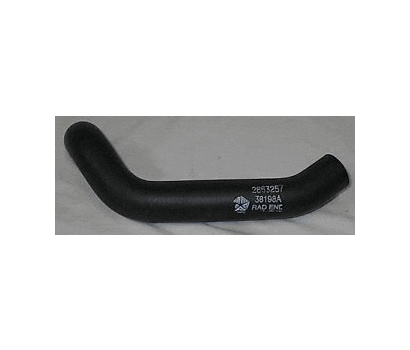

Yup had the same problem. I purchased one from Mancini racing because they show the part number and logo on their website. When I received it and it had nothing on it, I called them and explained they have an issue with the picture on their website, was told yes they know about it. I think it is false advertising, just to get people to buy it, but it does not have any markings. They lost my business.
see what I mean
You will not get what you see in the picture. They were told this 2 months ago, still have not fixed it. Misleading the buyer.
I did call mrmoparts yesterday, they had one pictured with logo, and the guy I spoke with said it did have it, but I'm not sure he looked at a part, because today, their site actually has an updated picture with part number but no pentastar !

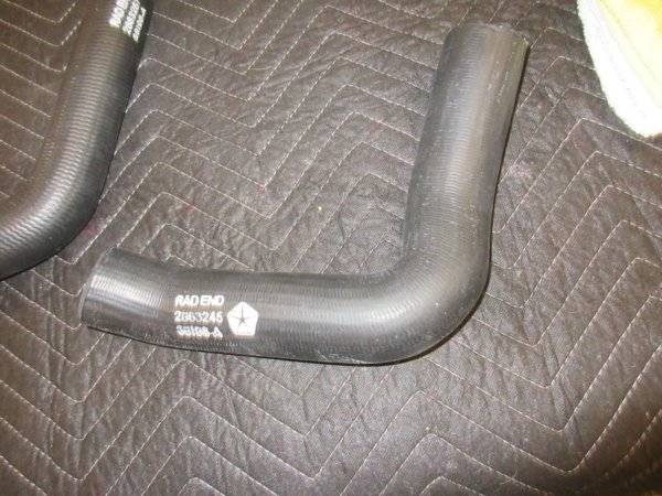

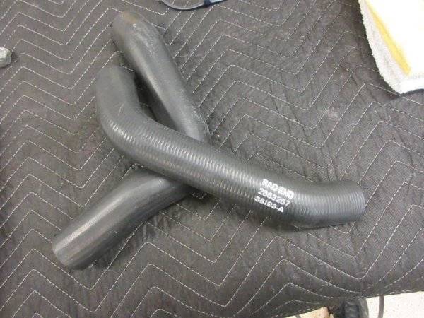

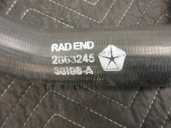

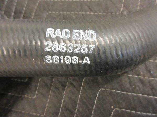

That is because the true original upper hose did not have a "pentstar"....The Lower hose did....For 1969
http://www.forbbodiesonly.com/mopar...y-father-my-69-gtx-restoration.127388/page-35
These are not NOS hoses but new reproduction hose and the markings were removed and restamped with the correct markings. Plants had variations on stampings and these were stamped based on original Lynch Road examples...
View attachment 567065 View attachment 567066 View attachment 567067 View attachment 567068

Has to do with the bottom numbers is the difference. Varied per plant....
Problem is people based information on OTC mopar parts versus true assembly line parts....There are many variations and only the high end restorers focus on these. It ranges from things like this to finishes and everything in between....Just because it is an NOS part does not mean it was the same as a assembly line part....
Also, the quality control on assembly line parts far exceeded OTC NOS parts.....
So when you see a correctly restored OE car these are the little things that separate them from the rest and only a few know of these things...
