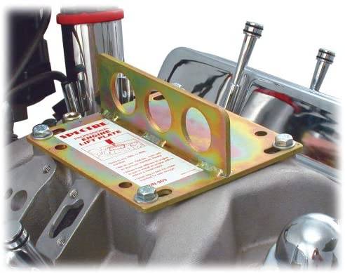

Thanks IYO where is the best place to lift the engine from.
A carb plate is the best option.
https://www.amazon.com/Spectre-Perf...ds=engine+lifting+plate&qid=1625696948&sr=8-3

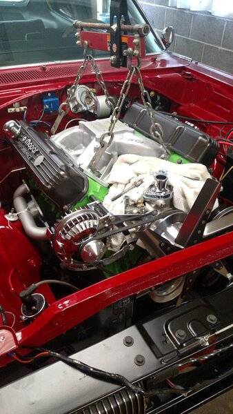

I just bought one of these. Kinda nervous to use it lifting a big block AND 727. Seems like it might pull the threads out of an aluminum manifold? Or should I just go ahead and swing it in there?
Be sure to thread the bolts all the way in, that will prevent thread damage. And be sure to use 4 bolts, no less.
I never cared for the carb plates
I know a lot of people use them but I agree it seems like a lot of weight on the sMall threads of a carb mount
I use the 4 corner intake BOLTS
