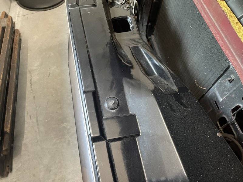

Here's my unrestored 68. I'd say that it's an 80% gloss finish.

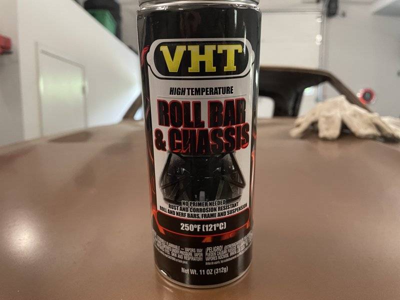

This paint does a good job replicating that finish & can be used on other similar underhood brackets, K-frame & other black painted items.

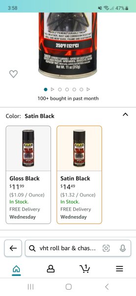

Is this the VHT roll bar & Chassi in "Satin" or "gloss"? i can't tell from the photo and see there are two options.. thanks in advance. I just want to make sure to choose the correct one you are recommending. Id like to also use it on my horns and power booster and maybe some other parts.
The roll bar paint that I used has a semi gloss finish. It's definitely not high gloss. I'd go with the satin.
