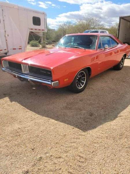

Ok thanks! Did you see the pic I provided of the car. Am I just not seeing the hood mounted turn signals?
Edit* Nevermind, I see they are down in the hood louvers which cannot be seen from this angle. I'm dumb

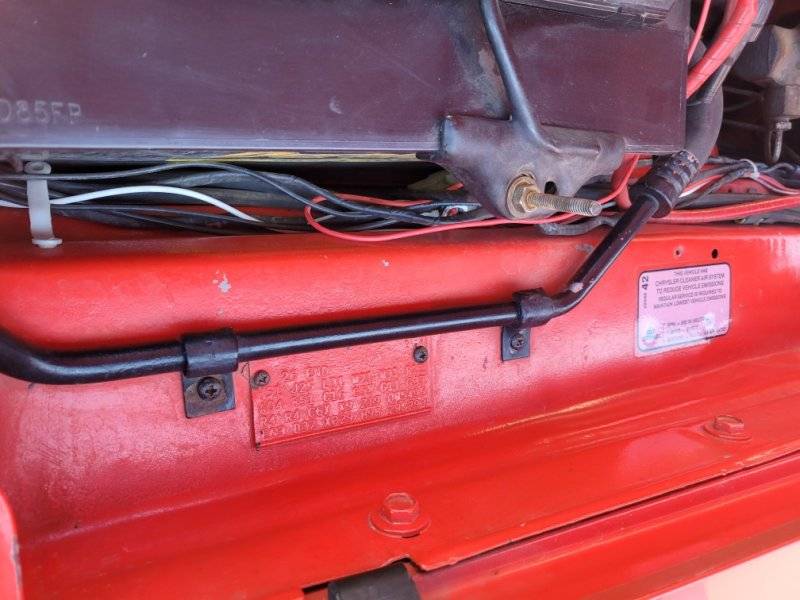

One final question, the owner told me the car originally came with a black vinyl roof, but from my research, the R4 R4 (Charger Red) color code on the fender tag and V01 code on the build sheet tells me it came mono tone and is not a vinyl roof car.
Can anyone help me confirm this 69 Charger did not come with a vinyl roof based on the pics below?
Thank you all so very much!
It did not come from the factory with a vinyl top.
How much they asking for it?
$72k but I backed out after talking to the previous owner who divulged that the trunk pan and part of the floor pan has been repaired using fiberglass. He also said the interior has been replaced with leather along with a few other interesting facts that convinced me to pass.
The search continues
