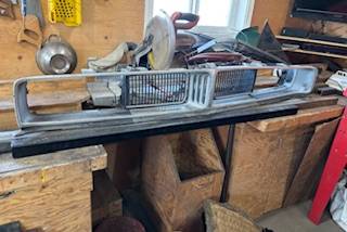

So I’ve restored the steel front grille mounting surround from my 69 charger, and the next step will be to restore the plastic grille itself that mounts back into the steel frame.
I’m looking for hints or tips on things like how to go about removing the fasteners that hold the stainless trim onto the plastic grille without doing damage, as well as paint suggestions for both the black, and argent areas of the grille.
I restored the grille on my 68 years ago but it has been so long that I’ve forgotten all of these tricks, and what paints I used.
Any info would be appreciated as I hope to dive in on the plastic part of the grille in the next day or 2.

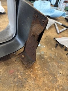

The headlight doors pivot on steel brackets that are riveted to the plastic frame, and I would like to remove these and blast them, paint them and then reinstall them later.
The rivets aren’t pop rivets (obviously); is it a good idea to remove these, and if so where would I find the correct style of rivets and tool (C clamp type tool I believe) to put these back?

Those rivets are a semi hollow rivet n are fastened like making a flare on a brake line

Since you are located in Canada, you might give Spaenaur a try. They have many oddball fasteners in their catalog and will ship Purolator. Spaenaur Inc - Fasteners Right Now
