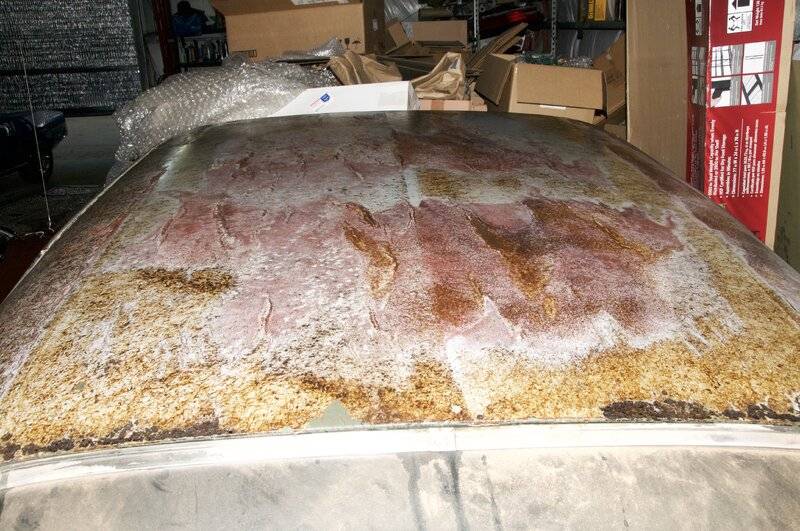

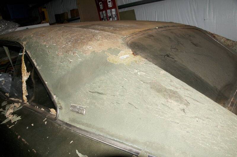

The roof above the windshield and above the back glass is pretty badly rusted and has rusted through in a few places. I'm treating the entire area with Ospho to stop any further damage. I won't be doing major work on this car until my current project is done so I have time.
Should I fix the rusted areas or replace the whole roof?
Gotta go with replace roof. A holed roof will be a bear to patch and even worse if you don't get all the bad spots cut out. Vinyl top car?
Pics would help us help you. Please post a few.
I usually would have but have had problems with my computer lately because it is on the verge of becoming obsolete. My iPhoto file is huge and makes everything run really slow. This time when I started to download photos, it shut the computer down and had to restart. Then iPhoto said it had to do a repair to the file which has taken about 2 hours so that is why I figured I'd just describe the problem. This is Bruno, a Trac Pack R/T SE. And, no, I don't have any girl cars, the balls are too big.

Yep. I think that's what held the moisture after the top started to deteriorate. I know how to weld sheet metal and know how to lead. The headliner is almost perfect, I hate to remove it.

Original metal fits the best. That actually doesn't look as bad as some. Had to tell without some overall pics from a few feet away, but I'd patch it.

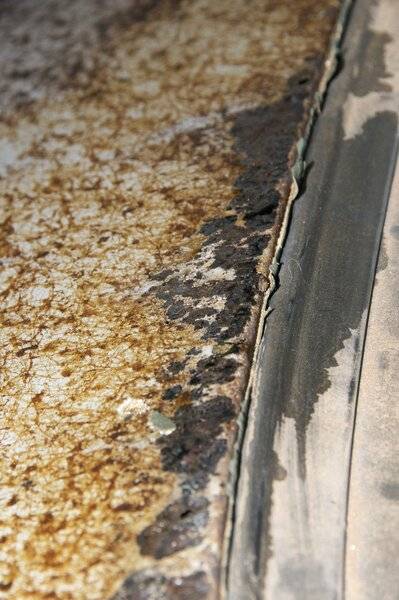

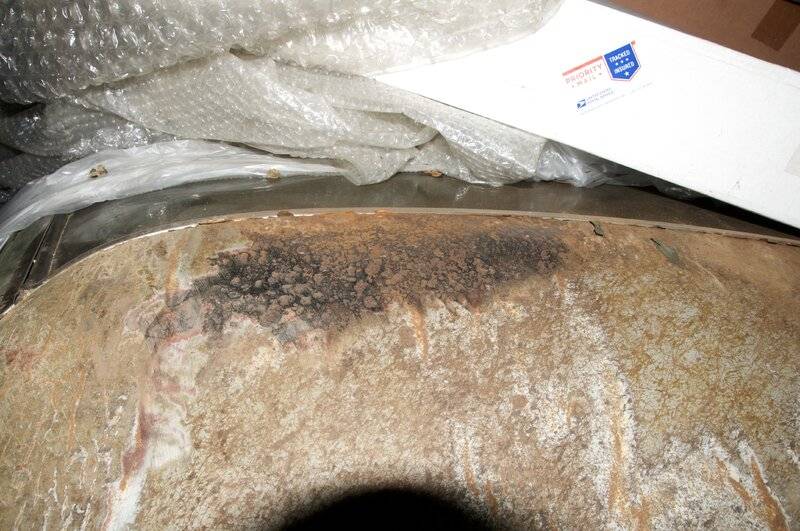

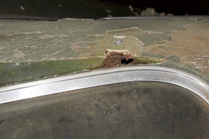

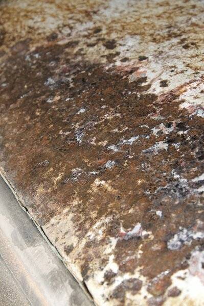

I would hesitate to make any decision until you remove the rust that is visible. I have stuff that looked bad and wasn't and stuff I thought would take an hour to fix, take all day. Pin holes with good metal around them you can drill and weld shut (copper backer if too large) just be careful with the heat so as not to warp that huge roof section. As Demonic stated above, original fits best. You will have to remove the headliner no matter what. IMHO You can always grind and sand the roof down, make your plan, and then epoxy it, no harm no foul and it will stop any further damage.

If you check out my thread in the members projects section,on page one I repaired a similar area above the rear window. It takes time to slowly weld it so you don;t warp it. The thread is titled Project rat rod V code 70 Charger R/T.

I used regular body filler to blend it,I suppose you could used lead if you want to. It only took a very light skim to blend the seam.I had purchased a new roofskin for the car,but after looking at the rest of the roof,I decided to repair the one bad area. I made up the pieces using the roofskin as the template. There are three pieces,the first piece was flat curved,and was welded in where the glass sits,the next piece sits upright,and was curved to go around the glass,and the last piece is the flat curved piece that becomes part of the roof. The key to a good repair is to take your time welding and grinding it. When you grind the weld,only grind the weld itself,do not overheat the metal around the weld,or you will distort the metal.
I think to get a good idea about how much rust you are dealing with you would need to spot blast the areas of concern. Metal thinned from rust does not weld without evaporating. But most important, make sure you get all the rust out before repairing, whatever method you use.:thumbsup:

Did you grind with a stone, flap wheel or DA grinder? I'm hesitant to use stone on sheet metal, in fact that was probably a stupid question. I know about heat - thanks, I've worked with stainless steel tubing.
