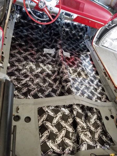

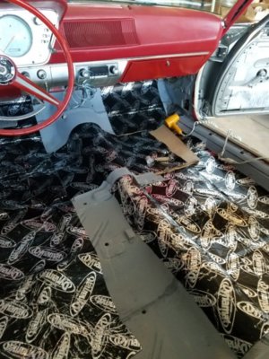

There are several good sources for sound insulating products including spray-on and decided to go with Dyna. Cost for the kit was around $150 and covered pretty much what I had thought could use it. I used some other materials adhesive duct insulation in the doors and rear quarters. Made a significant difference but with the loud exhaust now (3" with headers thinking of less noisy mufflers) and being a drop top now I hear the wind noise better. I spent a lot of time prepping the floor for this some 3 coats of primer and ensuring a good coating around holes/drain plugs.

I used Eastwood's Rust Bullet Rust Inhibitor Paint on the El Camino after wire brushing the entire floor. I capped it off with Eastwood's Rust Bullet BlackShell rust preventative and protective coating paint. It's overkill but that floor will never rust from the top side. Let's face it, these cars are not water tight and/or get liquids spilled on the floor.
By the way, you do not have to cover the entire metal surface with sound deadening material. I think the recommendation is about 2/3 or so. Once the carpet is don nobody will see it.
