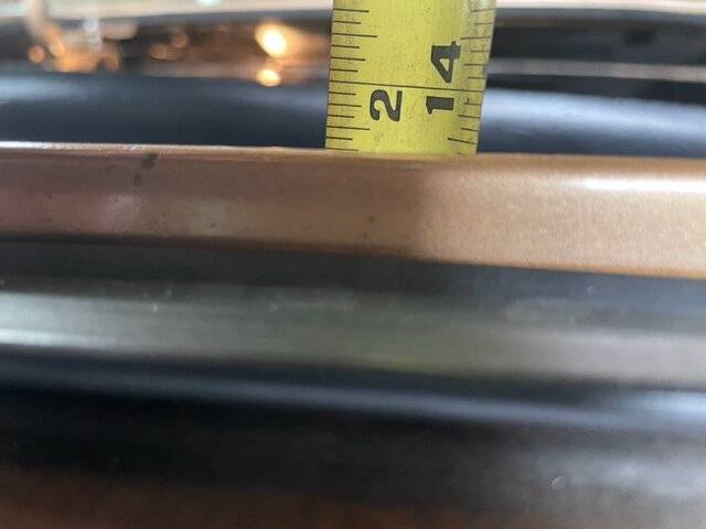

Thanks. Maybe a few pics looking along the rear bumper. Interested in how the bumper is positioned. I think it gets even gaps when looking at it from the side of the car

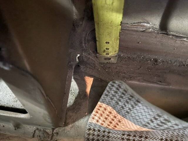

I've got plenty of pics but uploading lately has been a pain in the ***. I'll give it a try.
Will NOT upload! I've tried two browsers and niether worked. :mad:

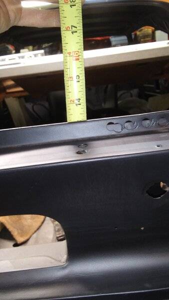

I've got 15 1/2". Hope that helps!
I got 13 1/4 and you got 15 1/2? Ok we must not be measuring to the same spot. The floor ramps up to a common level that goes all the way across. Thats where I am measuring to

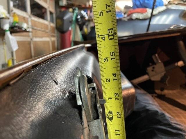

Hard to get like yours with the taillight cover in place. The end of the tape is in front of the latch bracket, on a good angle.

Merry Christmas Don. Unbolted the cover. Big glob of sealer at the latch bracket bottom, but the end is close to the left taillight. Within a 1/2" of yours maybe.

Is your car original? And thank you so much for the extra effort. So you measured down to that ledge that goes across the back?

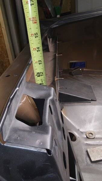

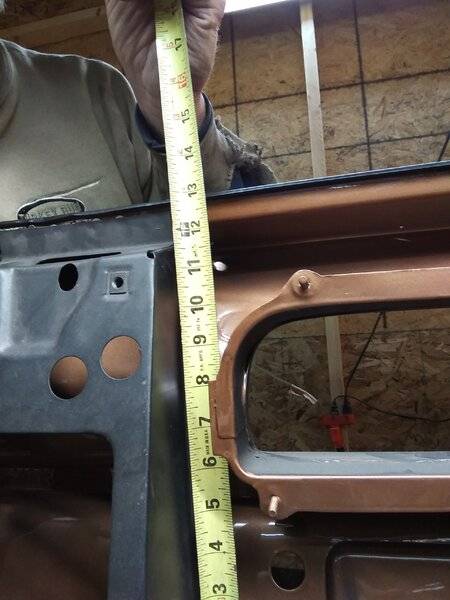

Actually, I have a car I can measure, if just for my own curiosity, that is still a shell. Sorry I didn't think of it yesterday. I have to move 4 cars to get my 69 out so a lot to do yesterday.
Yes, I'm the 2nd owner. Never hit. I saw the flat section you mentioned when I took the cover off.
