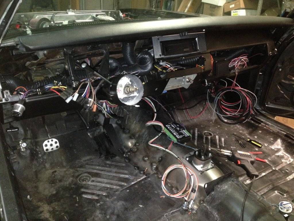

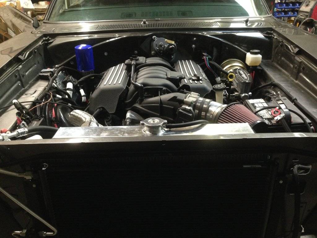

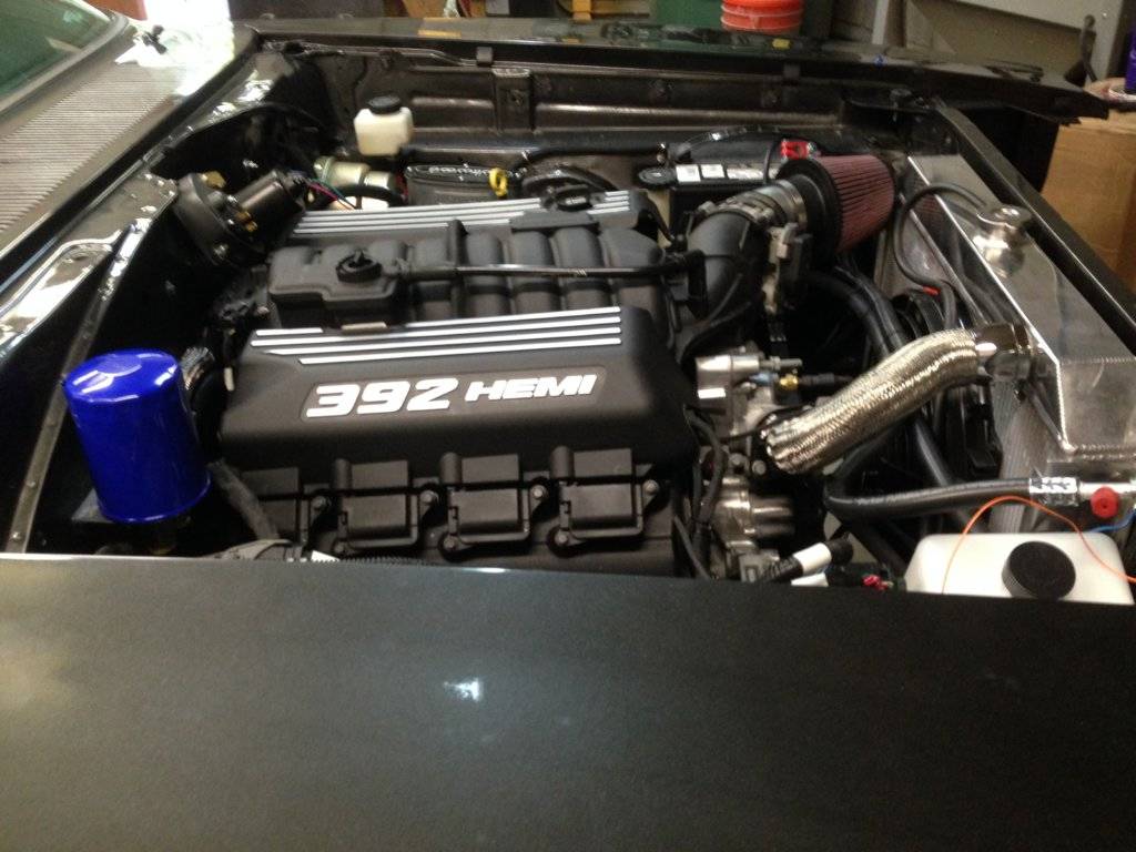

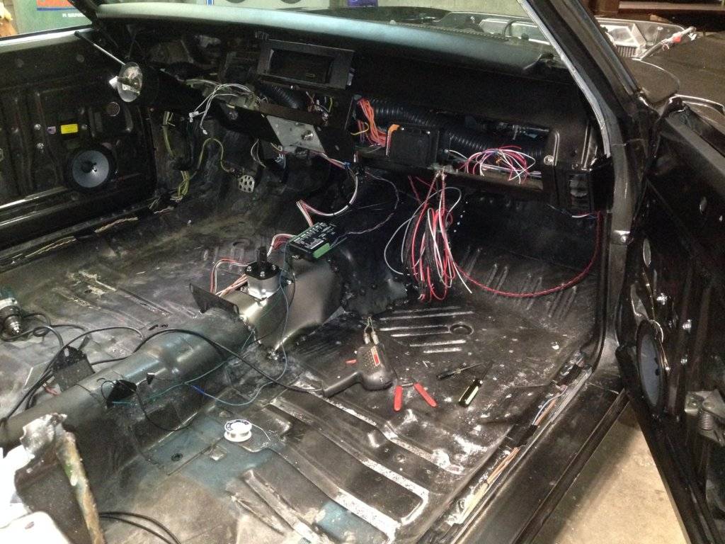

We're building this '69. It has the 392
with a Mopar Engine Kit wiring harness. Almost ready to fire it, just a few more wires to go on the dash.

The 392 look like if fits nice. Did you have to cut the fire wall? is it a car motor or truck motor ?
I like it! Well...........All except the oil filter location. I remember seeing a Crosley 4 cyl car at a show with the filter mounted in that position. I always wondered how much clean-up was required after an oil change.
Looks very clean...Did you utilize a kit of some kind to modify the trans tunnel or just cut as you went?
Cutting the firewall/trans tunnel all depends on the transmission you are using. If you use the Hotwire harness you will need to drill a hole in the firewall for the wires to pass through.
They make a 45 degree adapter to help clear the K member that mounts the oil filter in the front.
I have seen that adapter . when installed it is directly above the k-frame mount and then the motor may not sit properly . I was thinking of just welding to the back of the f-frame motor mount (pass side) and shorten the motor mount , then cut away the factory k-frame mount to make the angle adapter fit . Any thoughts ?
I ended up cutting off the end where it contacted the K member. The big trick was finding an oil filter to fit the space. I was at summit racing and they ended up calling Chrysler and the part number Chrysler said to use with that combo was 4892339AA. It is a smaller filter but it will fit in the space.
