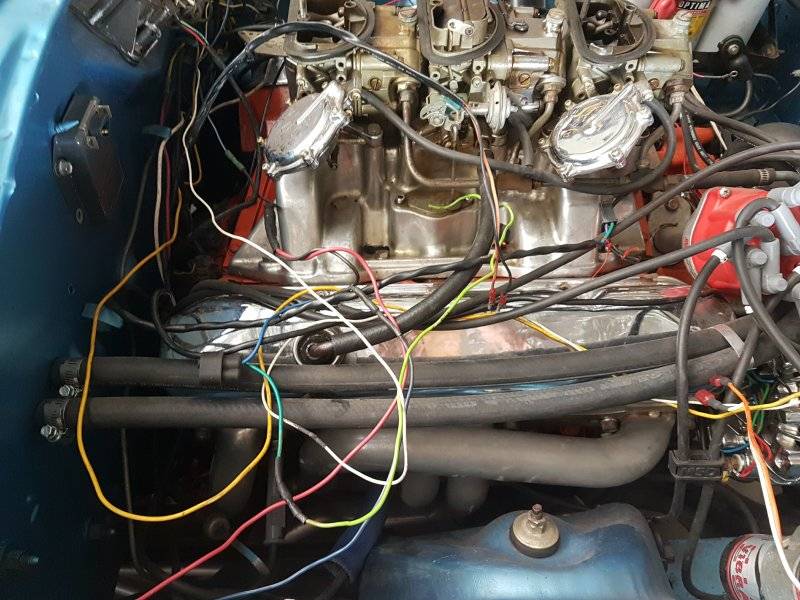

First thing i started doing was in vane. I tried repairing the wiring. After much mucking around, the whole wiring just got binned and i decided to make it myself.

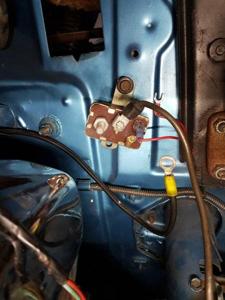

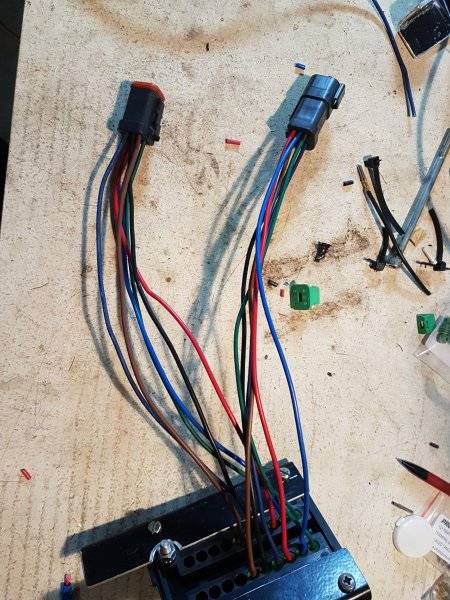

Ive made the harness but want to get braided once the build is complete. The harness is going to run under the DS wheel arch and out of the eng bay all together. Ive added a relay bank and some new switches. It now has a Dakota Digital dash because the swept one didnt work and i wanted a different look. This car was originally a 318 column so being original on this build isnt something im sticking to

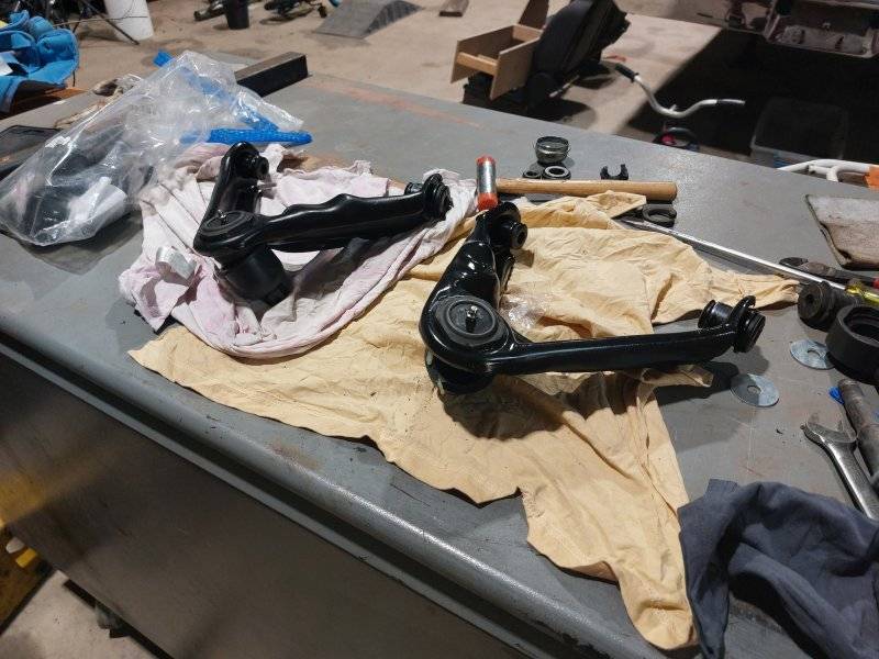

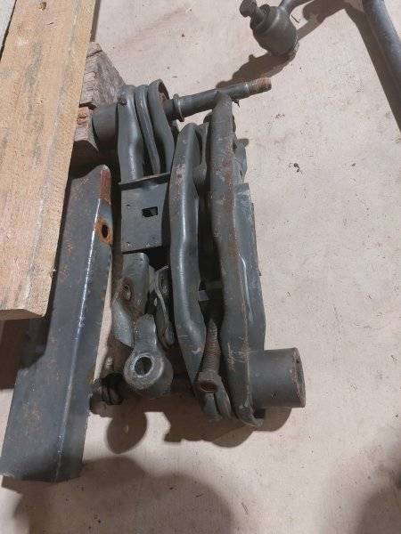

I bought a front end kit from PST and re kitted the front end. Gave it a quick freshen up while i was at it as well.

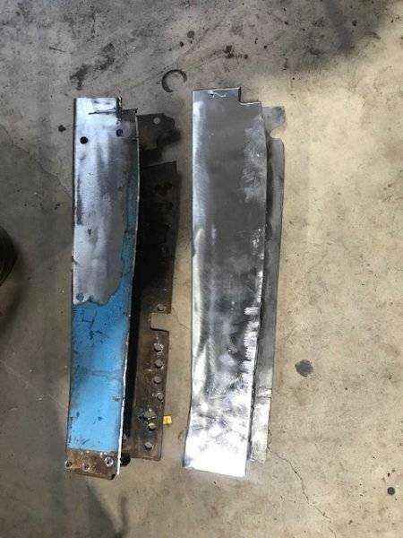

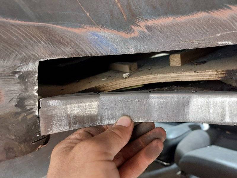

I cut the old rail out and made a new piece out of some 2mm sheet i had in the shed. I have made it a little different to what the original is. Instead of using the lap on the join at the top on the inside i have chosen to make it flush. Just never like the look of the flap of metal hanging over. But now i have to do the same on the other side. It was my first crack at anything like a frame rail but overall im pretty happy.

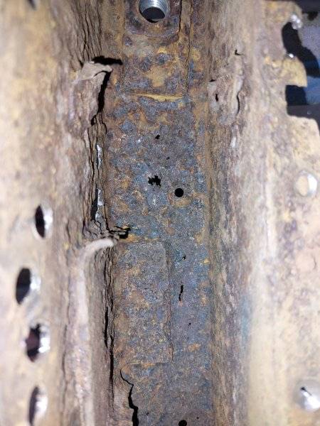

Some more shots of the frame rail and what appeared to be a rats nest inside.
I have found some old repairs on both the rear wheel wells. it appears they have welded a piece of sheet over the top of the cancer. so i have started cutting that out and patching it up

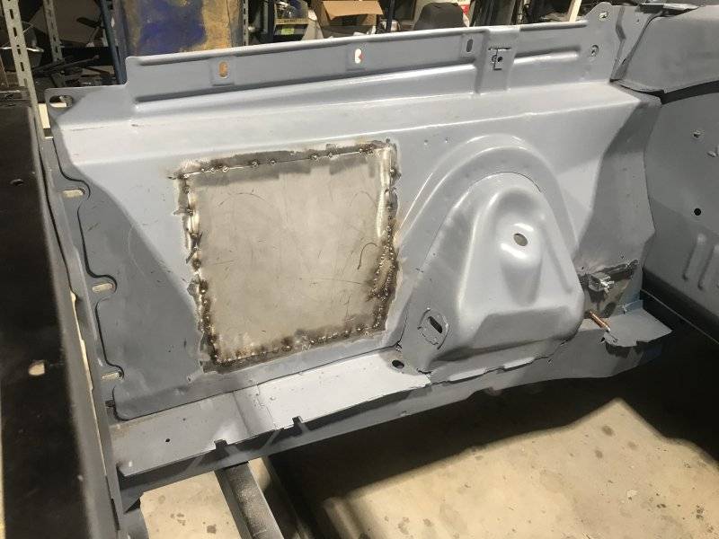

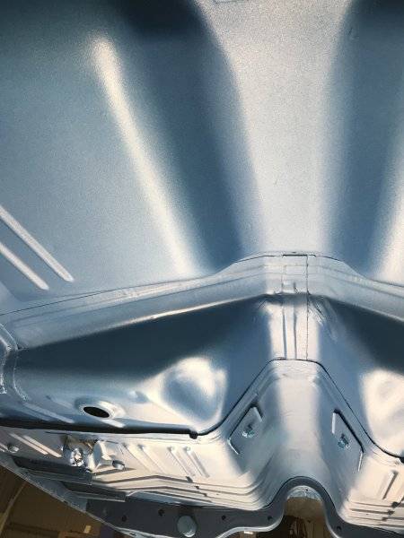

Dec 26, 2016
356
147
Australia

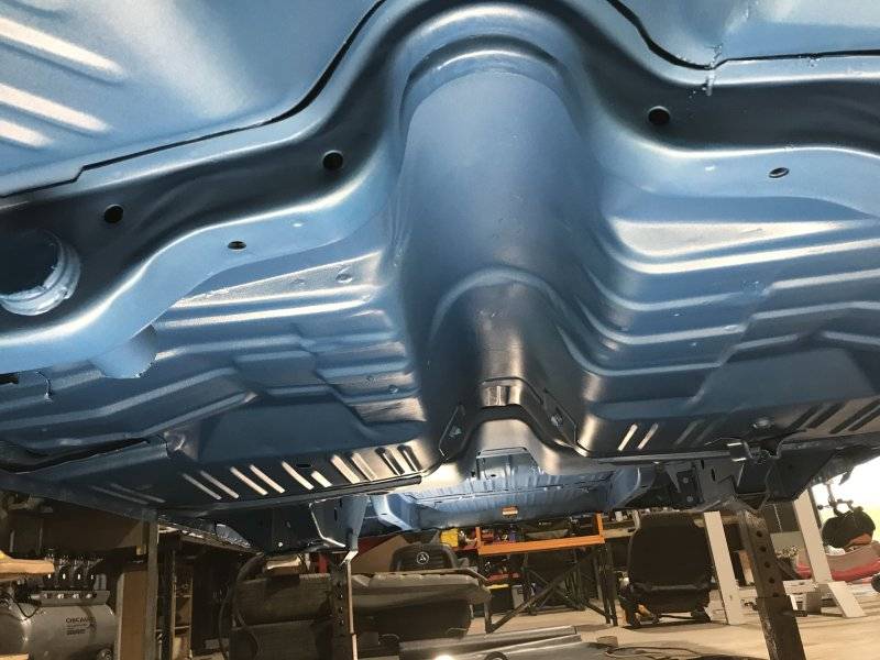

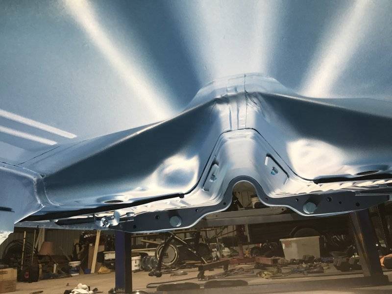

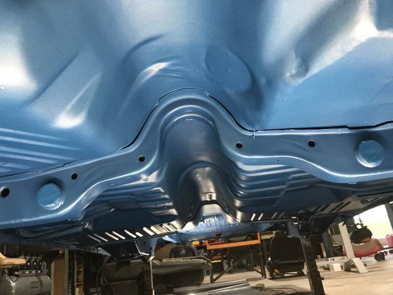

Have got the engine bay all welded up. Just needs some filler and another epoxy. Underneath ive coated in tinted raptor. Turned out pretty good. Will be needed here on our roads in QLD. They leave a lot to be desired...

Just an FYI on this build. The underneath and engine bay are getting done first due to possibly moving house at the end of the year unfortunately. So i would like to get the undercarriage all sorted before then so i can at least drive it out of here.

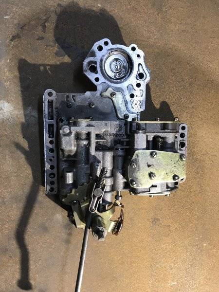

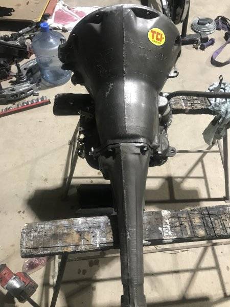

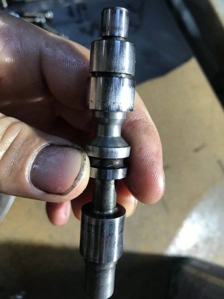

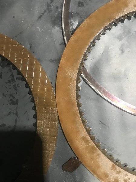

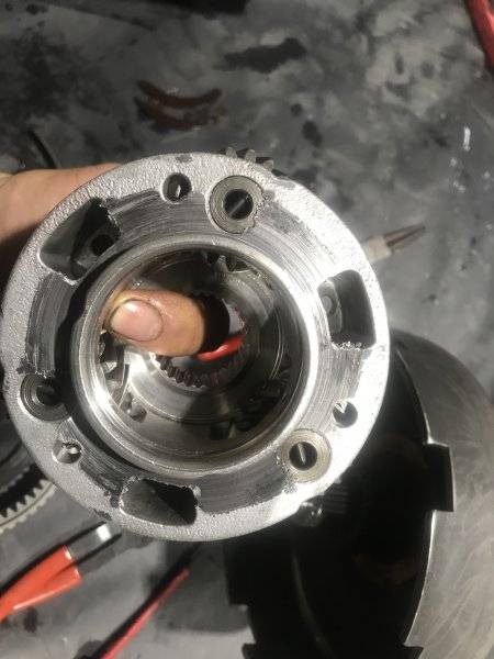

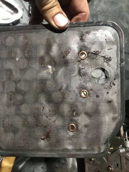

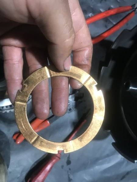

So we are now up to current progress. I pulled my trans sump to have a look into the so called "New" TCI tranny.
Found some debris in the pan so i decided to strip it down. I made another thread in the trans forums about it and thanks very much to all the guys in that thread who have helped me through it.
So now im trying to sort out parts from either CRT or a local guy here in Aus.

That is going to be a beautiful car when done. Sticking with the B5 blue I presume? If so, I would recommend using PPG Deltron for paint. I just painted my Road Runner in that color, and the PPG is a much nicer color than Martin Senior or DuPont.
That rust sucks for certain, but I guess it could have been far worse. Looks like a mouse nest in the frame rail. Pretty common around here. They build their nest and then their piss rots the frames from the inside out.

Yeah I’m glad it was only that one. All the rest are solid. I am cutting a small section from the other front one but bugger all.
