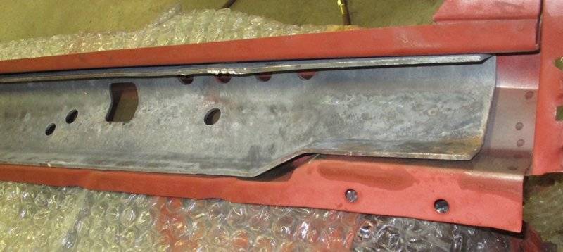

The piece is convertible only. That's a known fact. If it wasn't everyone and their brother would have said so by now. Go look at peoples build threads where they replace rockers. You will NOT find that part in anything but a convertible .
My convertible Cuda' has them.
My Dart does NOT.
If you find a hardtop that has them from the factory, you'd better buy it. There is the off chance that someone put them in your car during previous work, but I can pretty much guarentee they weren't put there by the factory (if they even exist).
Also, the part is NOT "sheet metal", it's plate steel. If you look at the picture above, you'll notice it's about 3/16 (almost 5 mm) thick.
Look here.. (convertible)
https://www.hotrod.com/articles/mopar-torque-box-medic-saving-mangled-e-body-metal/
A quote from this one (since you don't believe me)
"These large C-channels are on the inside of both rockers on convertible cars only to make up for the support lost from having no roof. In the lower right of the photo note the damage to the splash panel and the wrinkled torque box plate. Somebody must have run over something fairly big?"
And here (hard top)
https://www.hotrod.com/articles/replace-rocker-panels-1971-plymouth-cuda/
If your car has these, then it's a modification someone made, but I seriously doubt they are present.
