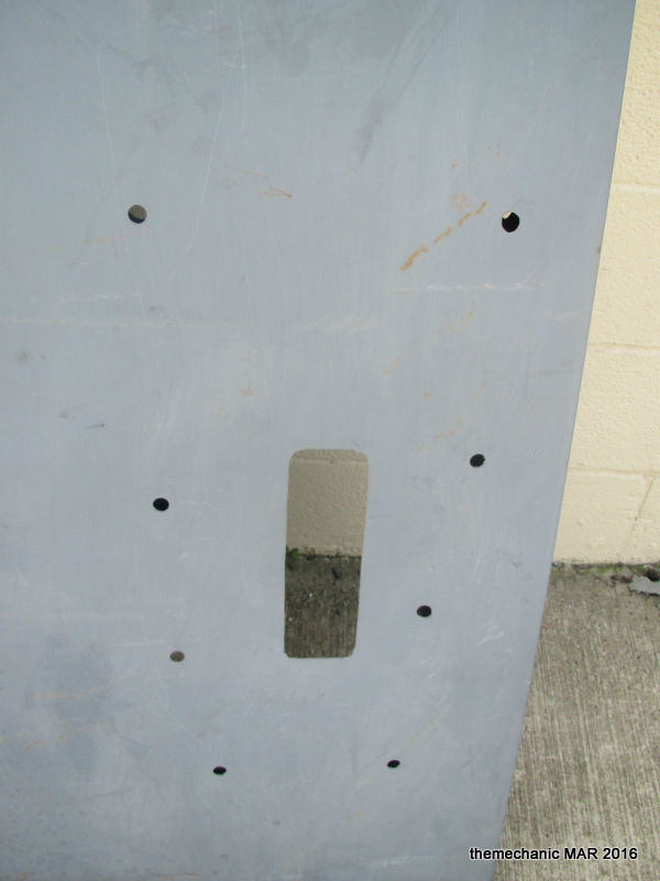

My 69 Coronet goes to paint in about a month to 6 weeks. I have the power bulge hood and a stock Coronet hood that I wanted to mount the twin scoops on. For a little more money I can get the second hood painted also and swap between the two. How can I find a layout pattern so that I can get the twin scoops laid out correctly? I would love to have the option of running either as both look good in different ways. Went through the search mode but came up with nothing. Thanks gents in advance.

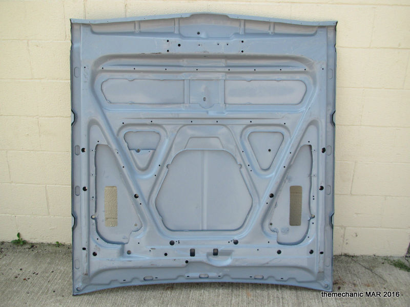

There is no gasket under the scoops. I thought the bracing on the underside of the n96 hoods and regular hoods were different. Which would make it difficult for modification. Someone correct me if I'm wrong or before Mocajava spends money when he doesn't need to.
Unfortunately I don't have a car to look at to tell you about gaskets. As for the under hood bracing I don't think there is a difference in the 69 fresh air vs non or the 70 fresh air vs non fresh air hoods.

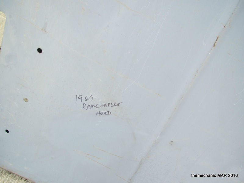

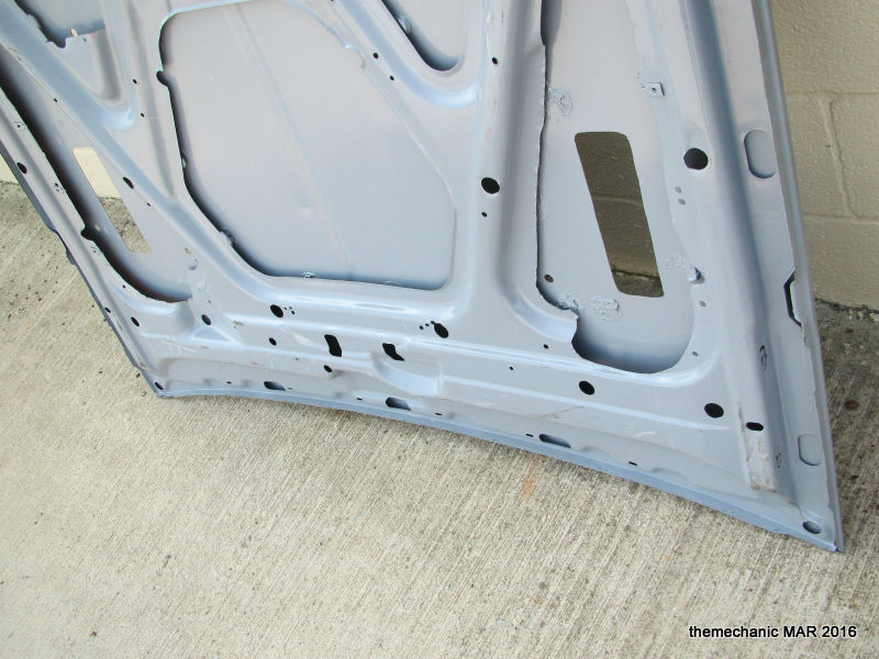

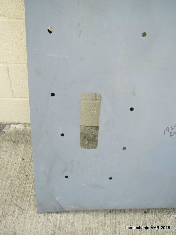

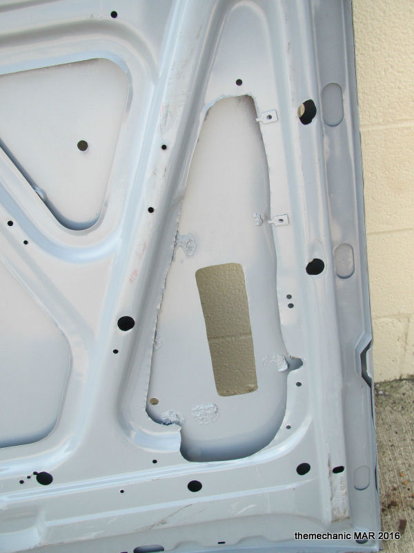

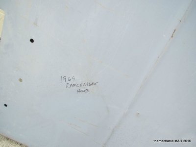

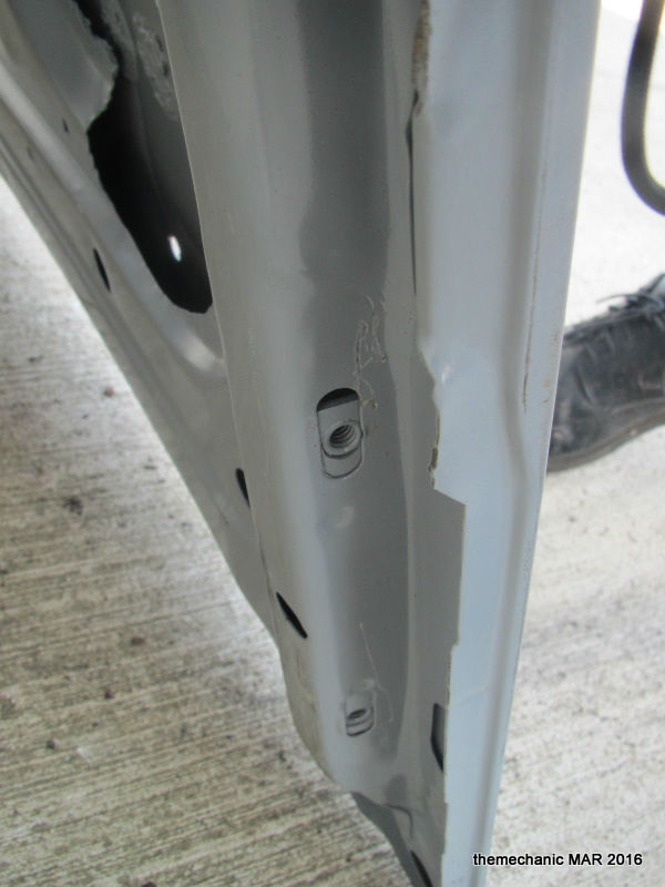

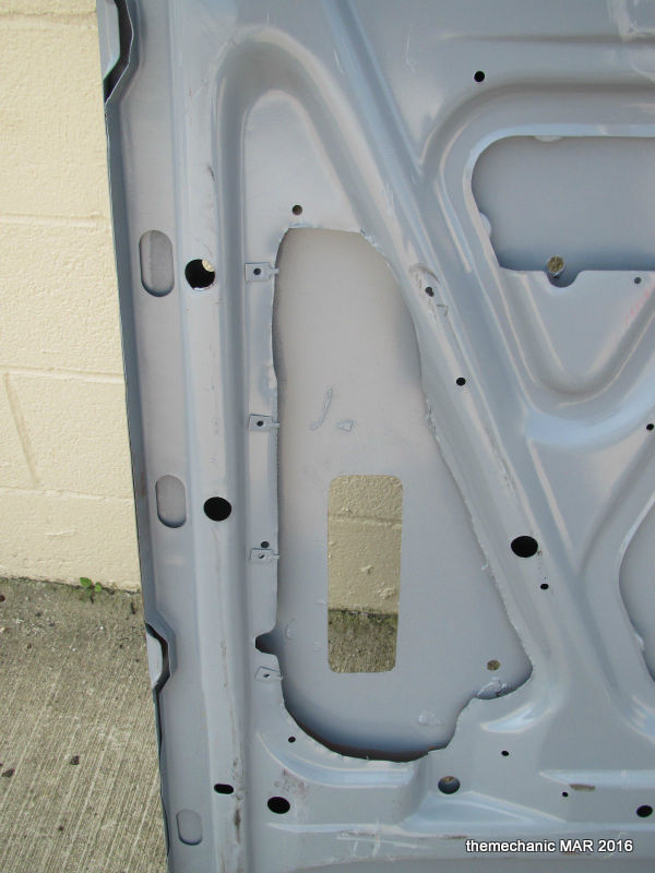

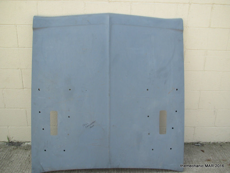

I bought my hood already cut and drilled. Here's a photo:
