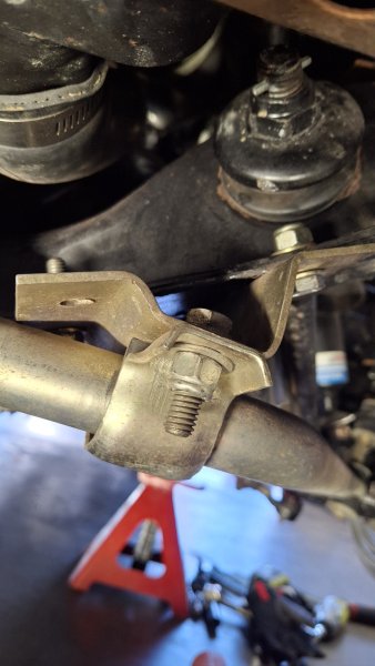

However, I noticed the paint chips on the big strut bar washers that hold the bushings on both left and right sides. It appears that the screws holding the aftermarket front sway bar bushing to the K member are too long and tapping the washers as the suspension compresses. I'm going to regrease the torsion bars and cut off the excess bolt length on those sway bar mounts.
