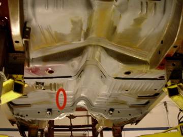

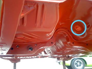

Bucket seats would have extra seat mounting holes inboard near the drive shaft...
And a console shift should have a hole in the side of the trans hump for the shifter bell crank to pass through...

So just to make sure, there should be 4 holes on driver's side and 4 on passenger side, if it indeed did come with buckets.
And, check for the hole in the hump for the shifter mechanism.

The holes for the seats and the shifter as circled....

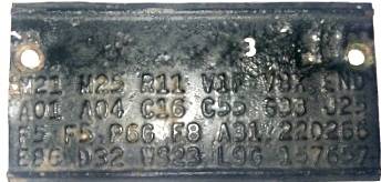

If you can, post a picture of the tag. It could be a bad tag.

This is very useful information, thank you very much. Here’s a pic of the fender tag.
Fender tag indicates it originally was a bucket seats and console car. C16 for console and C55 for bucket seats. Who knows what has happened to the car over 50 years.

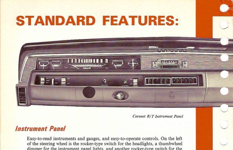

I was reading an older thread on this forum that 150 sweep speedometer was standard and rally was optional.
1. This car has a 120mph Sweep, but according to this pic from hamtramck, they could’ve come with this from the factory.
2. The inspector confirmed the vin on the rad support but didn’t look on the trunk seal.
Is the rad support welded onto the frame or bolted on? I’m wanting to make sure that this is an rt w/o having checked the trunk seal. The vin on the dash matches with tag and rad mount. Can this be enough verification?
The car originally would have had 150 mph dash. Correct,that sweep was standard and rallye was optional. Radiator support is welded on, so not a quick easy swap.
