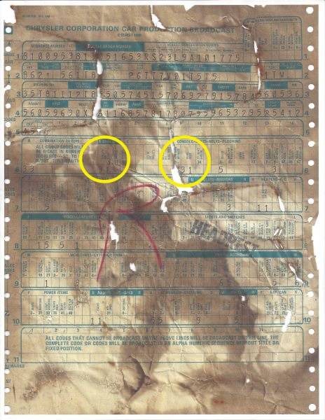

I don't have any history for this car, but hopefully someone can answer my questions from the attached build sheet. Is this originally a power brake car? Should it have headrests? Anything stand out? Especially interested in upgrading the brakes, as they don't operate well. Thanks

B31 tells us HD manual drum brakes
C31 tells us the car had headrests on both seats.
Thanks for the info. Now has power drums, no headrests.
The sheet says HEADREST in a big stamp lol
